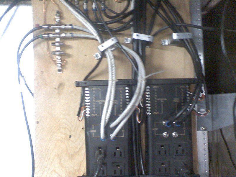

Just how is your system grounded because it sure sounds like it maybe your problem. I've got five dishes now and haven't had any issues with all the storms and power issues we have here in Iowa. For one thing I would never ground at the dish unless you can hook it back to the electrical panel in the house. Here's a picture of the way I'm grounding and then I ground everything to a single spot in the panel. All the cables going to the dish go into the SurgeSat-Guards and my receivers are hooked into APC UPS's. Also all my cables going to the dishes are enclosed in gray plastic pipe for added protection.
If you want a SurgeSat-Guard there are some on EBay # 330393606212,360235011586 for around $20.00.
