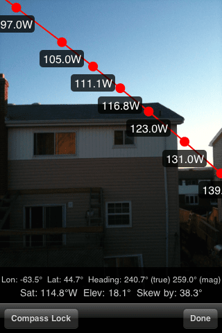

I want to set up the "new" 12' monster I picked up but the only place the wife will let me put it is behind the house. Fine. My 7.5 is there now but I do have LOS issues with it.
I want to plant the big one out back to keep her happy. The house is in the way and the dish is big and heavy so I can't lift it far to get it mounted.
The question is, is it critical that the bottom rim of the dish can see a particular satellite? Or is it enough that I make sure that I can see the sat from the top of the pole/dish mount? This will determine how tall the pole should/must be.
Attached is a screenshot/photo of what I'm facing. I'm six feet tall and it was taken at eye level.

you might be ok but then again you might not get all your sats on the arc. i have a similar problem with my dish. i had to install it at the back end of my driveway and im about 10 to 12 feet away from the neighbours 2 story house and i still get from 72w to 121w over looking his house. his trees kill my 72w feed but i can pick up 87w to 125w and from 127 beyond his trees out front kill the rest. in the fall and winter im clear of everything as soon as the leaves are gone.id mount it up to just make your wife happy and take what sats you get. if your wife is like mine and she sounds the same take what ever you can get to stay on her good side. you really cant get a big screen in the dog house and trust me i tried and then the dog bite me cause he thought the remote was a bone, lmao
good luck my friend and let us know how you make out.
Is there any way to do a temporary install to see what you can pick up -- verify with your receiver?
I was a bit too lazy to do that, and I have a terrible view of the sky in my backyard, so I used the solar outage last fall to find the ideal spot for my BUD. The sweet spot in my yard is pretty small.
Although I can't answer your question about the bottom rim of the big dish, I can say that my Ku dish on 97W is blocked by the eve on my garage on the one side of it, and it still works fine, even though maybe 1/6th of that dish cannot see the sky.
I don't know that there is a "temporary" way to install a 12' dish as a test. ;) If anybody knows of one I'm all ears.
Even if at eye level I can't see a sat, the dish will extend six feet higher, and to the sides, than eye level and at that point it would pick up a signal. Whether it's enough or not is the question. The dish mount would have to be at least 7' off the ground to accommodate the bottom 6' of the dish so I suppose LOS would be better at the top of the dish, being 13' off the ground at the top.
