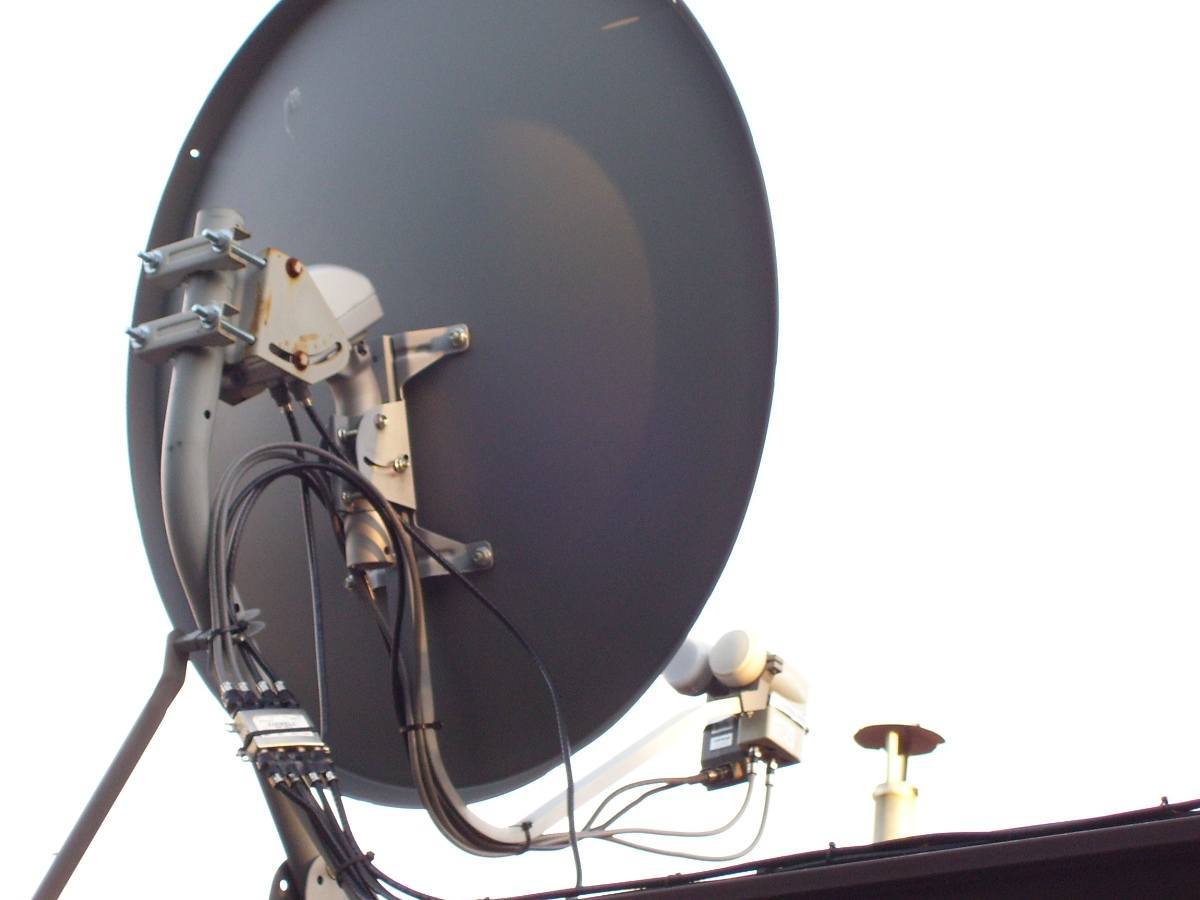

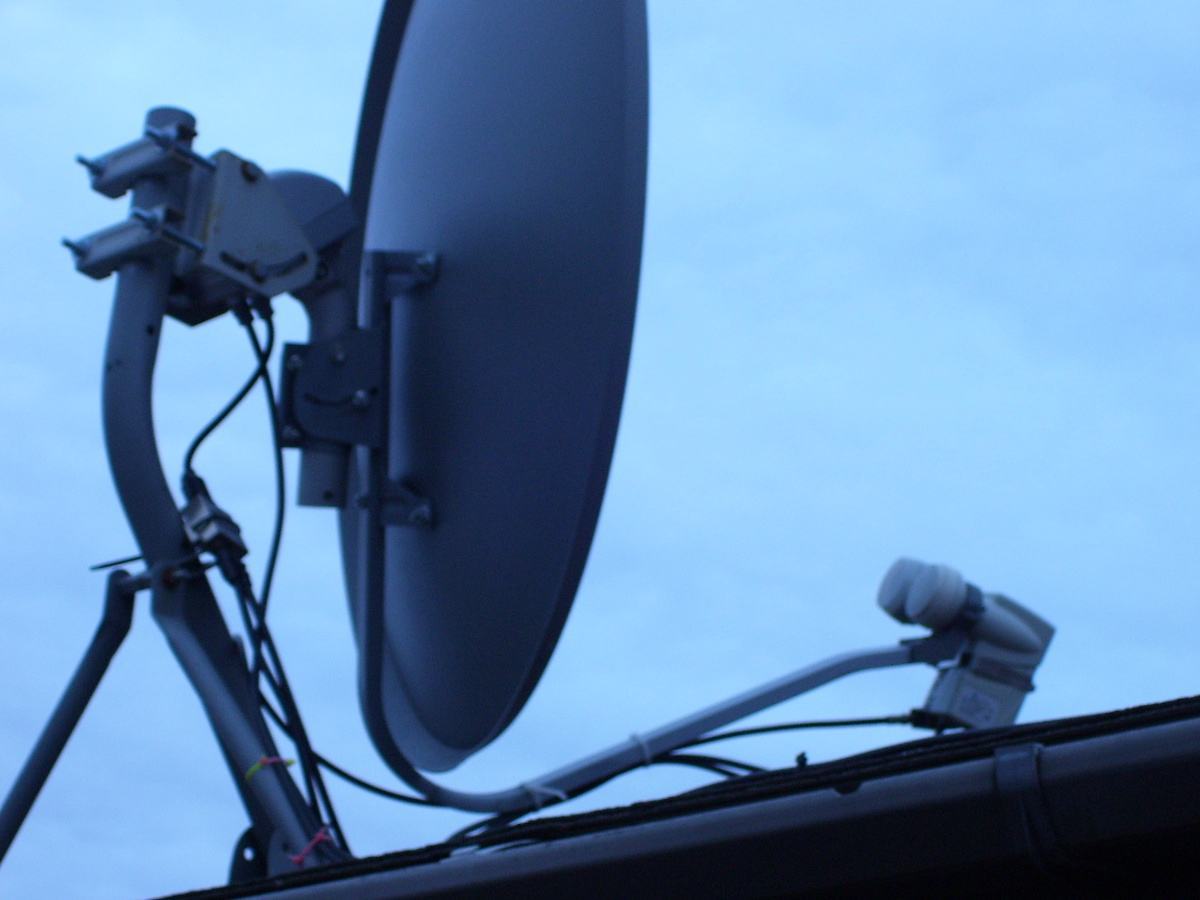

I just slapped an old DIrecTV LNB next to the KU one so I can get all the DBS freebies out there (there isnt much on 82,91,110,129 but it doesnt hurt to have it) :)
