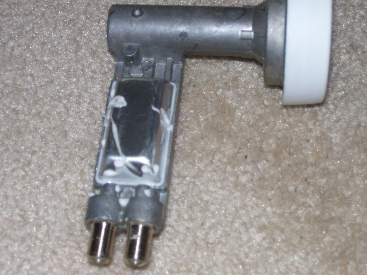

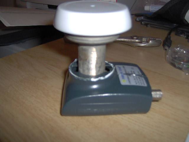

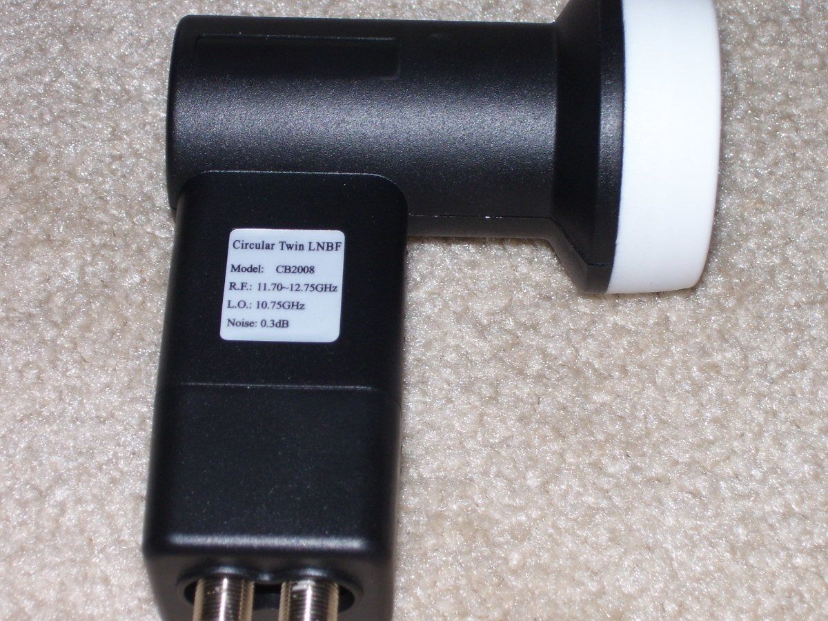

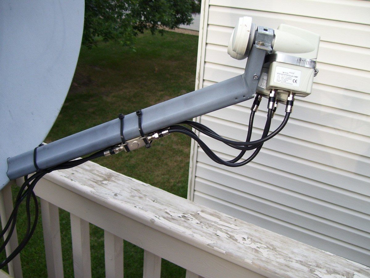

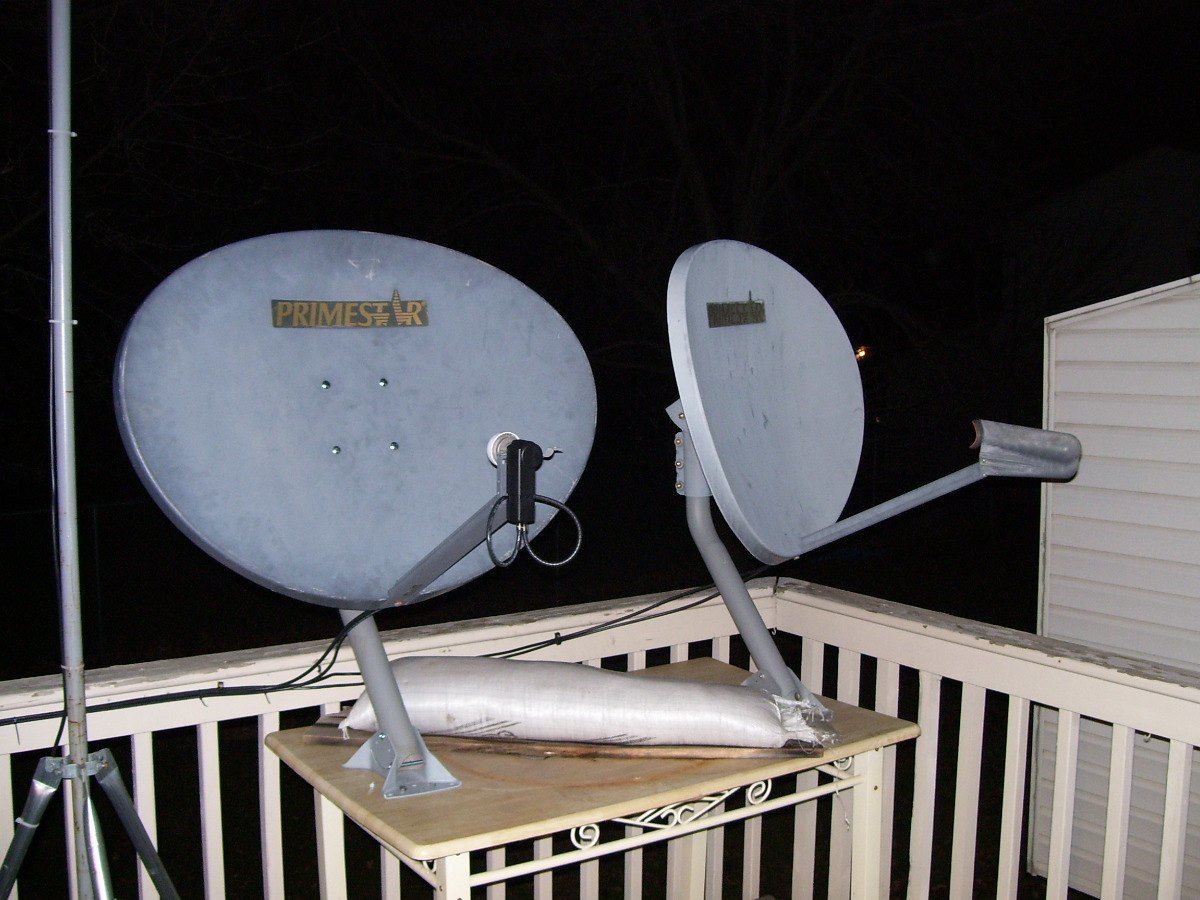

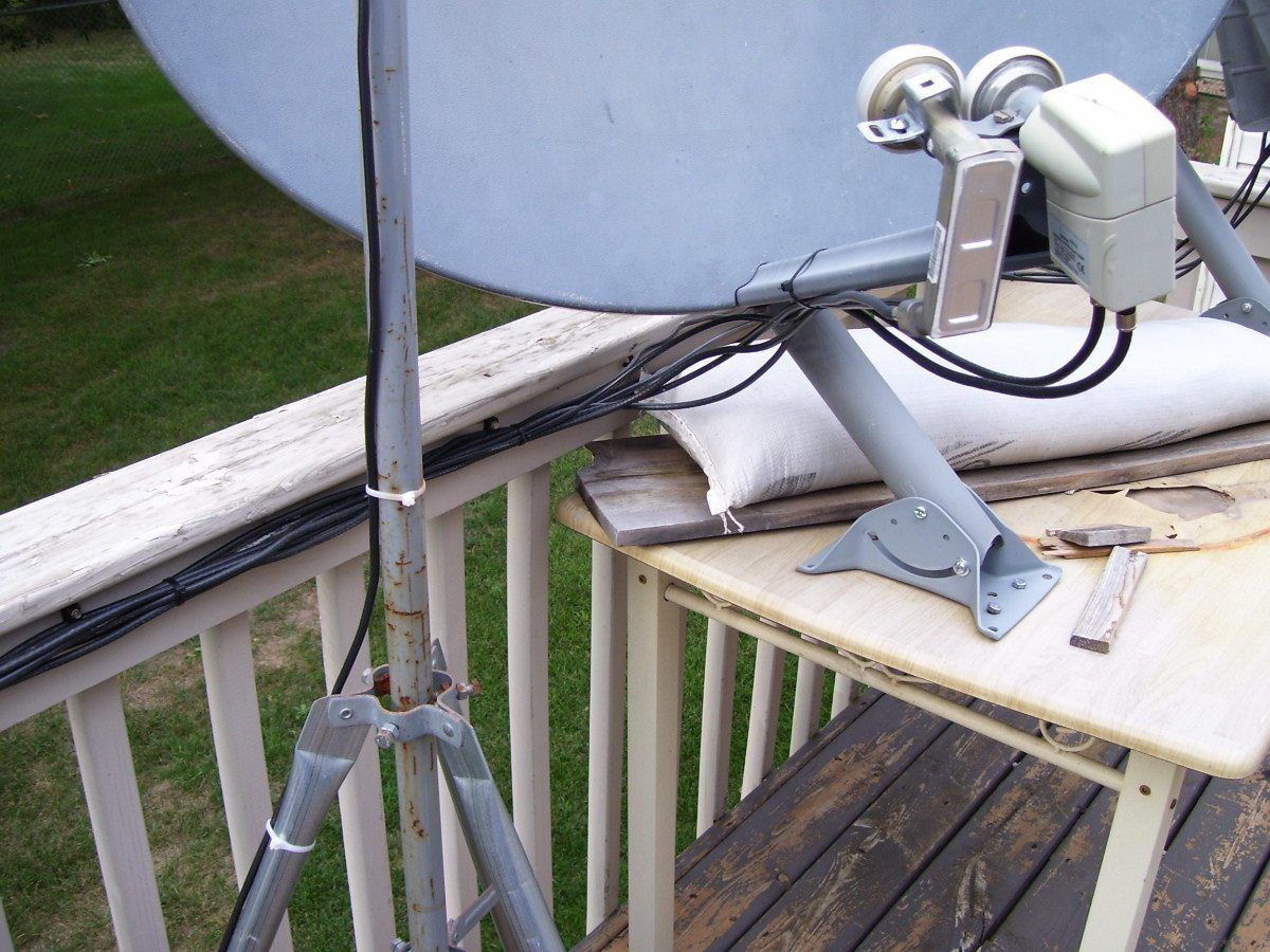

I have done that numerous times. Just gut the plastic off right behind the eye and you're fine. Some LNB's though it wont work like that because behind the eye isnt 25mm
Here are some examples. The 1st is a LNB normal and 2nd is gutted. The others are dishes where I did that.

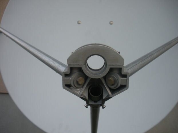

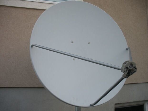

Here are a couple of pictures of the dish and mount. The LNB I have is a California Amplifier brand from my old BUD. Yes -- I do realize that I will only get one polarity with it. However, that should be adequate for testing as I am thinking about experimenting with this dish as a mini-bud.
Thanks.

The feedhorns in my collection are bolt on and will not fit that mount (I have the same dish). For that dish I have found that a specific feedhorn is not necessary. A stripped down offset type LNBF should have quite good performance. Losing approx. 5% SQ when swapping out the two output feedhorn to a LNBF. Never got into further experimentation to determine if the loss was related to the different electronics or the feedhorn / waveguide.

Just a follow-up on this thread. I ended up buying dual output DMSI universal LNB. I was able to remove the plastic case fairly easily with just a screwdriver. The throat size of the innards were 0.8", so I had to wrap some electrical tape around the throat to built it up to about 1". I then mounted the LNB and aimed my dish at IS9 where I was able to quickly find a signal and tweak it in. In fact, I was surprised how strong the signal was from IS9 being that I am in the west. Outside of a couple channels with color-bars, there doesn't seem to be much else on this satellite at this time. Does this satellite get any busier at other times? I assume the main content is feeds.
