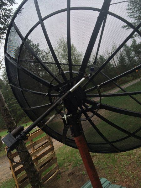

Okay,dish is on a polar mount so you should only have to set the skew once and it will track all the sats.IF you have the dish properly tracking the arc.When you change sats how are you moving the dish?

Well you're making a lot more work for yourself.Get the dish set up to track the arc,set the lnbf once and don't have to touch it again,and use a 12v battery/charger/jump box,whatever,to operate the motor when you want to move the dish.

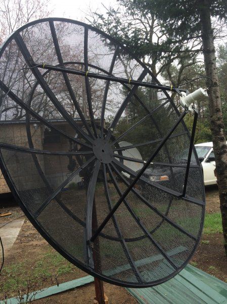

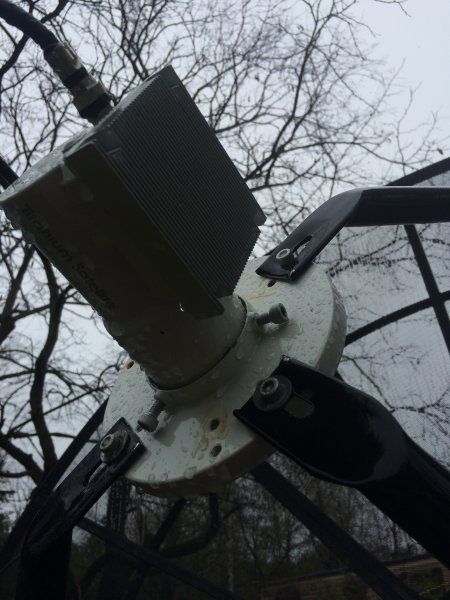

I'm still having problem. I don't have a cover on my lnb its in the wide open. It work yesterday all day but today I couldn't get it to work for the life of me. It seems that the 101 for me is so hard to tune. But any other bird is so easy for me to tune and watch. Idk I got a tree to the right of the dish when standing behind it. If it don't rain tomorrow I'm going to mess with it and try and figure it out bc it's kinda driving me nuts lol. I take some pics and show you what I'm working with.
