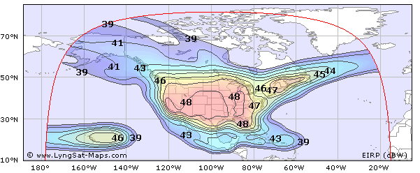

Hi Shane , I think we have a couple members here from the Rio Grande Valley who might be able to give you testimonial on the signal quality from Galaxy 25 but from what I could see looking at a Footprint Map on Lyngsat you are borderline 47-48 db and a 36 inch dish is more than sufficient.

he's wrong again. Checking Lyngsat (pic at bottom) both of us have the same levels (48) so the dish should work fine. Again, I'm using a smaller dish than you.
