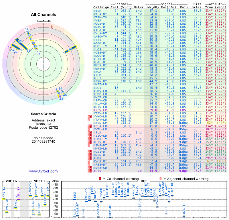

Thanks for the help. I went to that website and here is what I got:

With that many station LOS (Line Of Sight) and under 40 miles away you shouldn't have a problem getting decent reception. Most of the stations for your location are in the UHF band with only a few in the high VHF band. Here is an antenna with high VHF/UHF coverage. http://www.solidsignal.com/pview.asp?p=HBU33&ss=382874 Range is 60 miles for UHF and 70 miles for VHF. It has excellent reviews. There are a few stations in the Low VHF band (real channels 2-6 in your report) that this antenna won't receive. Unless you intend to use a rotor, point the antenna to 322° on a compass. That's where the majority of your stations will be. Good luck!

(for the price) I'd be willing to put up a Stealth Hawk DIY http://www.satelliteguys.us/xen/threads/ricmond-va-new-to-ota.339086/
around 30 ft in the air. May add an amp like a TVPRAMP1R
http://www.walmart.com/ip/RCA-Antenna-Pre-Amplifier/14554631 or a Channel Master 7778, if some fade out occasionally. Should do well except for the VHF-Lo channel 2.
If only interested in the stations to the NW (334°)
There are 2 on VHF Hi, one on VHF Lo, and the rest UHF.
I'd go with something like a suburban all channel antenna aimed to the NW.
One model is the Channel Master CM-3016,
