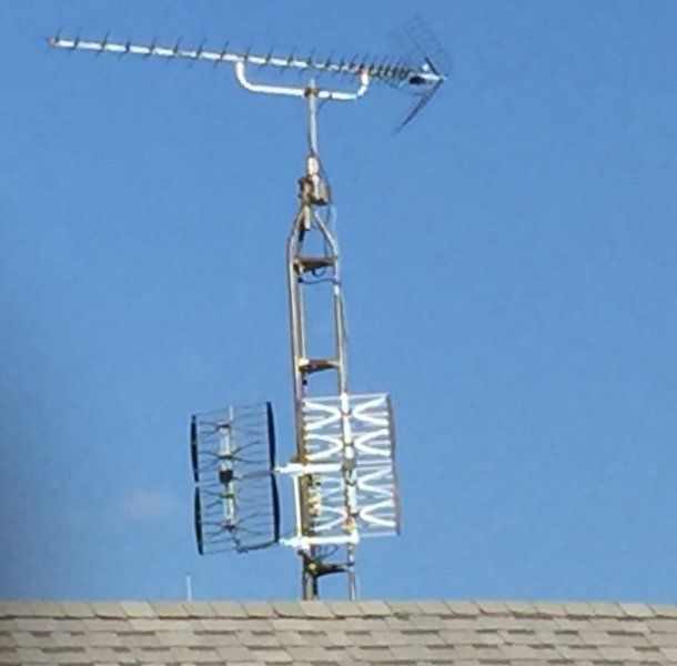

That is a tough one. The general answer for deep reception is to add height and elements. How high is the antenna? What are you using? Something like a Channelmaster 4221 up 30-40 feet might do wonders.
These are my antennas at 25' plus a channel master booster. I am too old to climb any higher.

They come down the tower separate then I am combining the signals just before they come in my house, then feed to a Channel Master booster.
To paraphrase on this topic from another forum I belong to:
"You can combine just about any two antennas with a splitter combiner, but know you suffer a 3.5 db loss from each antenna compared to being used alone. For example you can have one UHF pointed at one town and another UHF pointed at another town. If losing 3.5 db is not critical, it can save using a rotor, but it opens up a whole cluster of possible issues. If you want to combine two same-band antennas using a common 2-way splitter, the antennas must be identical and that is an absolute rule because both antennas must have the same electrical (RF) properties."
In other words, it's generally *not* a good idea to have 2 different UHF antennas pointing at 2 different cities and combining them on the same coax. It's best to use 2 different feeds with an A/B switch. The decrease in gain might be the difference between receiving the locals in Columbus or not.
Thanks for the info. I wondered about that. Looks like a little experimentation is in order.
