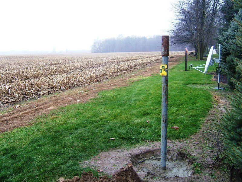

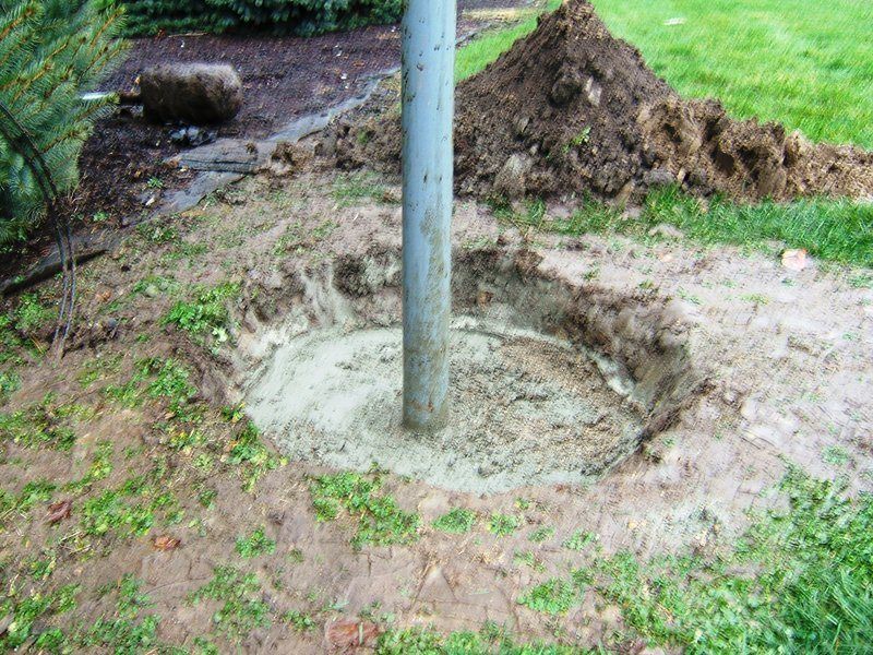

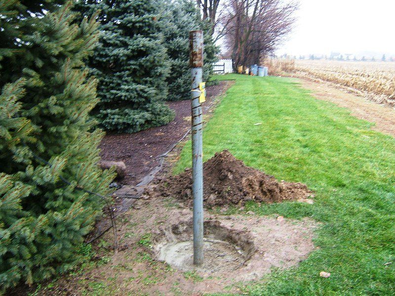

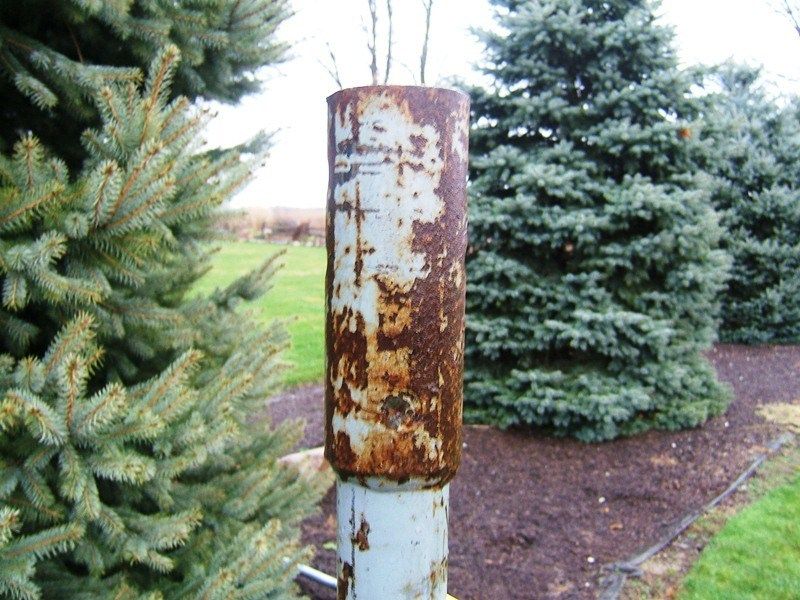

Thought I would update the information on my install for my new C-Band dish. Today, my son and I set the pole for the dish. The hole was 3ft down and 24 inches wide. My other son that works in construction found the steel pole for me. I'll have to get the name of the pole he got. The top section fits like a glove that slides into the mount. I will get photos later before I place the dish mount on. I used 6 bags of quickcrete. Three bags at 50lbs ea. were the better grade and three at 80lbs ea. bags at regular. I used 2 ea 12 inch screw bolts with washers and nuts through the lower bottom area of post. This post is not going to move at all. I think I went for the over kill, but did not want to do this again. My dish is 7.5 footer, might even be 8 foot. I'll have to measure when I have it togehter. I would have photos as I was doing this, but it was a heavy mist at the time here in north central Indiana. The temp was 49 so not to bad to work in and get the pole into the ground days before the cold sets in. I'll update later when things start going up.

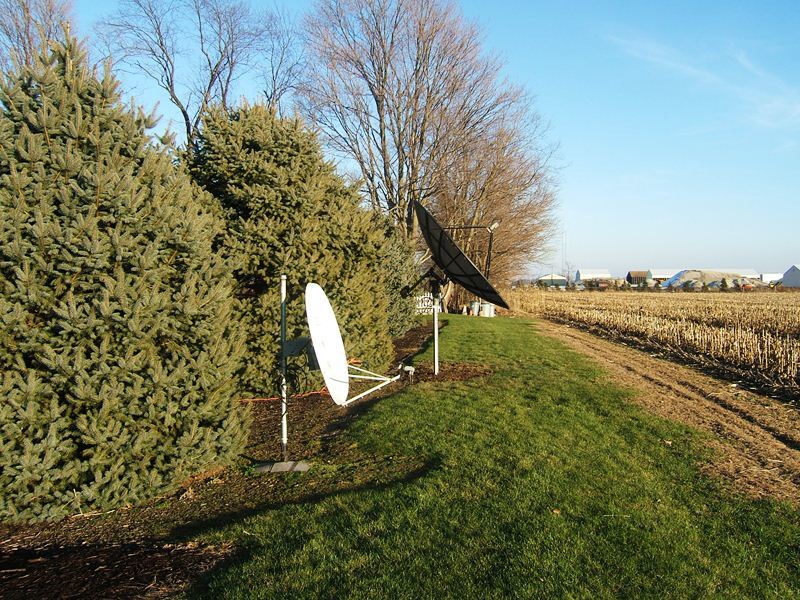

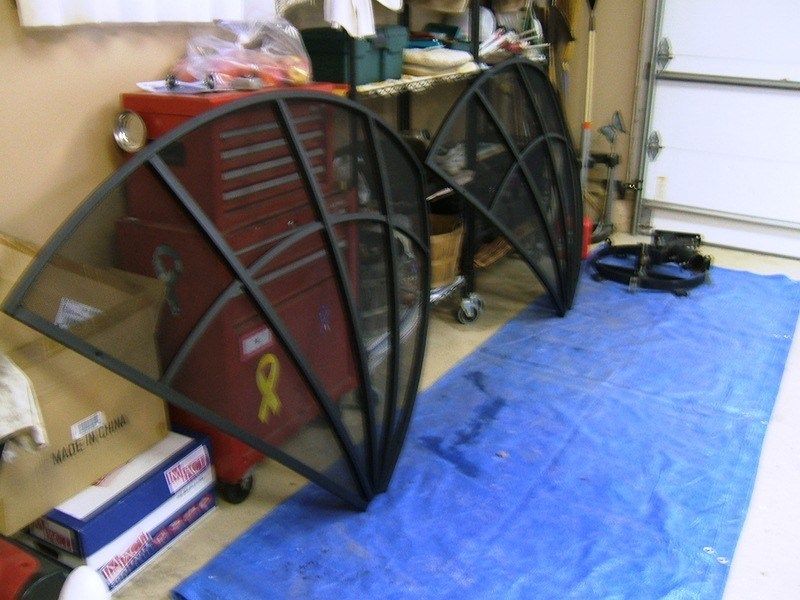

I went out and took some photos in the rain. I will clean up and paint the post this spring. The pole is very plumb and holding. You can slao see my Ku band dish with motor in the back ground. The Ku works like a champ. I also finished cleaning and painting two of the four sides of the disdh. I have the four small post , mount and two sides to finish up. Will add later.... My true south is 87 West and the field is wide open to all the sats I need.

I never did it the way KTI said to do it. I always assembled the dish. I then put the mount on the dish while it was still on the ground. Then would mount the dish on the pole. At that point I would assemble the quad pod to the scaler ring. Then place that on to the dish and put the bolts in the bottom 2 arms. Then tilt dish to one side and bolt that feed arm then do the other. Run the wires to the polorotor & LNB. Insert the feed assembly. Put actuator on (if not an H2H) and done. If I had help it was pretty easy to lift the dish in place. W/o help I had what was called a dish crane that attached to the pole and lifted the dish to the correct height using a crank that pulled a steel cable wrap around a hub and then I could drop the dish on the pole. I do think you went a little over board on the concrete for a 7.5 ft dish though. About 2/3 of that amount would have been plenty. The amount you used would have been more than enuff for a 10 or 12 ft dish. But now that it is done shouldn't have any problems and who knows maybe you will replace it with a larger dish one of these days.
