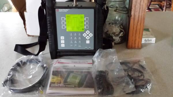

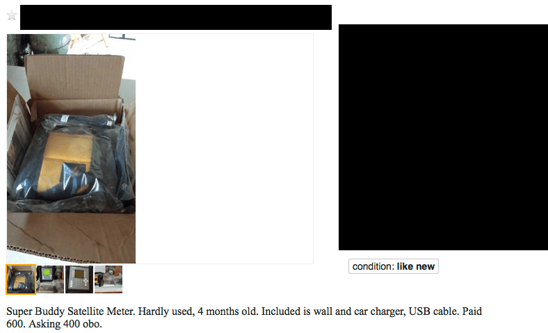

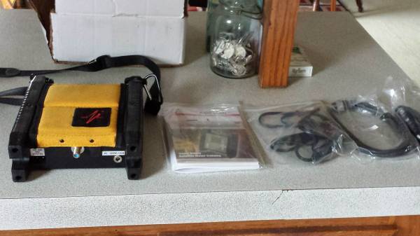

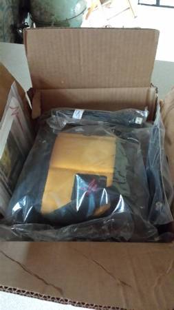

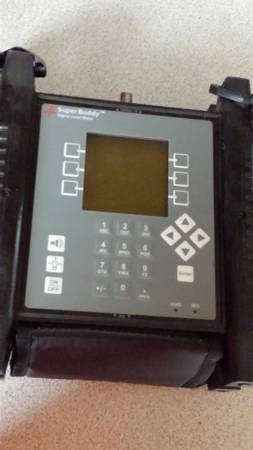

Well I've pretty much decided to buy a Superbuddy. I found one NIB for $400.
It's still wrapped in the original plastic and all the manuals and cords and stuff are still in their unopened bags..
It's even in the factory box.
I don't think I'll find a better deal. I found a lot of them on ebay used for $250-$350 but every single one of them was beat all to hell.
I'm worried about the membrane buttons on them.
For a few dollars more I would rather buy the NIB meter.
Now I don't know if it's still for sale and likely won't know for a day or so but here's to hoping! :D
