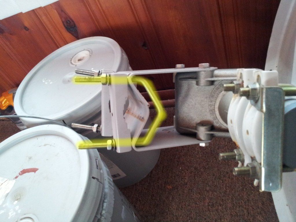

I'm looking to remount my motorized FTA dish but have a slight issue.
When I went to loosen the bolts, I discovered they were seized. I need the brackets and cannot find them locally.
See the highlighted pic for details.
Thanks for the potential help.
Todd.
Looks to me like your brackets are fine, but the nuts are locked into the threads.
Ill assume they aren't cross threaded and the threads are still intact...
But if they are, some have bought threaded rod and made their own replacements
Have you tried PB Blaster on the nuts?
It's a super penetrating oil we all use to get things apart.
As a last thought, you can apply a torch to the nuts for a few seconds.
When you put it all back together, use a dab of antisieze compound to prevent future problems.
edit: some motor manufacturers have replacement hardware.
What brand is yours?
Yeah touch a torch to it, but not very long as anole said. If not just get some thread rod and done..:)
You can also cut the nuts in 1/2 by cutting along the axis of the thread down to the thread from opposite sides of the nut. Get (a) new nut(s) and apply anti-sieze as per Anole. This is a common problem with stainless steel threads.
Bob
If they are stainless they won't be corroded in place. They'd likely be galled. I'd put some lubricant/penetrant on like PB Blaster then take them off with a box end wrench or deep socket. You want good nut engagement so they won't round off, then turn until they either turn or twist off the rod..
I believe stainless steel is fairly succeptable to galling.
This page describes the problem, and several solutions.
http://www.estainlesssteel.com/gallingofstainless.html
Exerpt:
Thread galling seems to be the most prevalent with fasteners made of stainless steel, aluminum, titanium, and other alloys which self-generate an oxide surface film for corrosion protection. During fastener tightening, as pressure builds between the contacting and sliding thread surfaces, protective oxides are broken, possibly wiped off, and interface metal high points shear or lock together. This cumulative clogging-shearing-locking action causes increasing adhesion. In the extreme, galling leads to seizing - the actual freezing together of the threads. If tightening is continued, the fastener can be twisted off or its threads ripped out.
Some SS varieties are more prone to galling, especially when they are used with another piece of the same alloy type. Differing material specs for the nut and bolt can help.
It looks like one of the threaded rods is stripped out just above the nut already. I'd just plan to replace the rod with a piece of threaded rod and move on.
