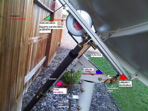

"marking the clicks" during alignment is futile as it will change as the alignment progresses.
Run the actuator up to center, the highest it will aim the dish, and then move the mount/dish on the pole to find the satellite nearest your latitude. Adjust the elevation for max Quality. Then find successive satellites E or west using the actuator. Using the actuator and adjusting the mount 'twist' for max. (DO NOT ADJUST ELEVATION) Don't necessarily have to do this on every satellite, 3-4 or 5th may suffice. Pretty soon you're at the end of the arc. Tighten it up and check the other side of the arc. If it's off there, your declination is probably off.
At Zenith(furthest UP the actuator places dish) preset angles:
Declination chart (Notice "modified" Latitude angle)
During alignment, just use the movers E W buttons, but don't store any positions. Just get it tracking first. Shouldn't take months, only a few hours, max.
