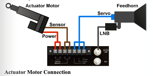

My quandry is, where do the motors get their power? From the receiver of course, but if the only feed to the dish is from the single coax, doesn't that go to the LNB? or do the motor and actuator arms have pass-through connections that also provide power to motors as well as to the LNBs?
I just remember an old BUD I used to have, had a 4-lead wire to the dish. Wires for the motor itself, and also for the LNB. But with the advancement of all this tech, I don't see extra outs on the back of these small FTA receivers for supplying power to the motors.
I guess a couple of pics would clear things up for me; one of the connections on a motorized Ku, and also an actuator arm on a BUD.
Thanks
HH USALS motors get their power and commands from the tuner. Set top boxes usually have enough juice to do that.
PC tuner cards rarely do. I could not have a PC operate a HH USALS motor so I ended up with multiple dishes instead.
The controller for a BUD has it's own power and doesn't draw power from a set top box or tuner card in a PC so that's not even an issue.

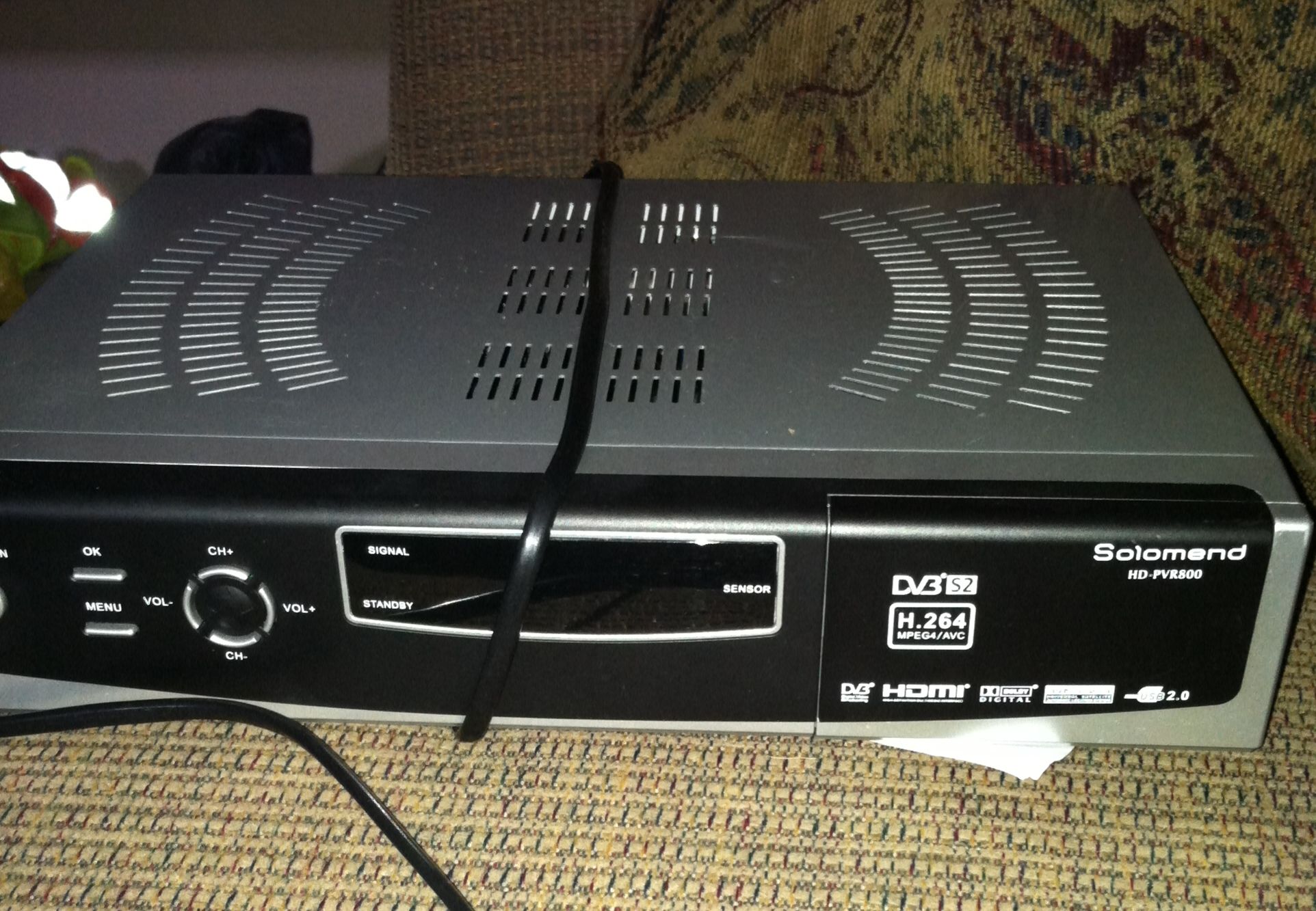

here's a pic of the receiver , there should be a receiver section here on satguys or ask.... i'm sure someone here has the same receiver its a solomend hd-pvr800 I think it was also commonly called a Skybox S9 HD PVR800 or Openbox S9
