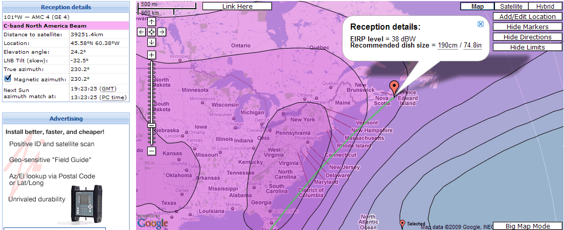

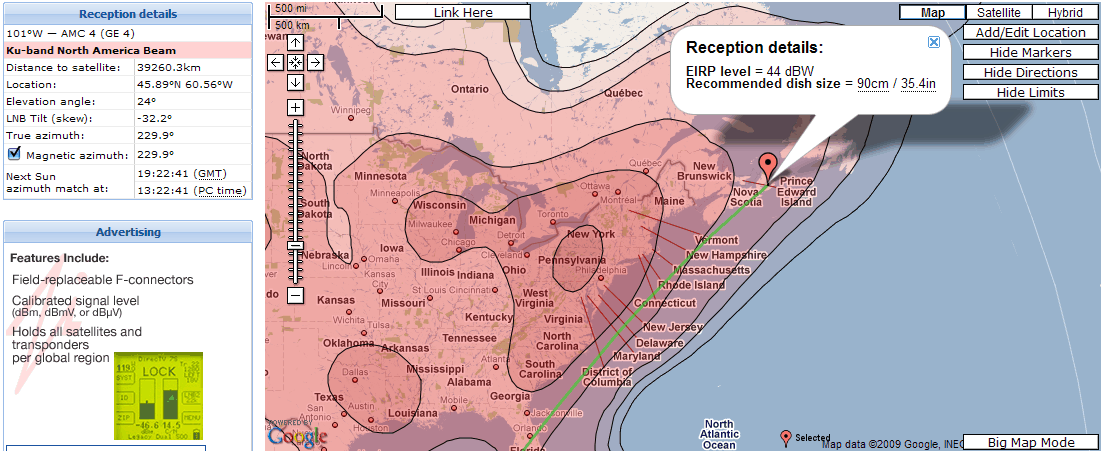

Charly,
Here are two footprint maps of satellite AMC 4 @ 101.0 W from Satbeams.com for you to reference. One is for the Ku-Band and the other for C-Band.
Hopefully this is some information that you can use. Disregard the dish and motor angles shown in the left box, they don't have a valid reference in these pix and are therefore meaningless for your location. If you register as a Satbeams user, you can enter your precise coordinates and obtain the accurate information for these angles. Registration there is FREE of charge, but you may enter as a guest and use just about all the available resources there.
This site also has channel and TP lists for you to peruse, similar to Lyngsat and SatCoDx, if you wish.
