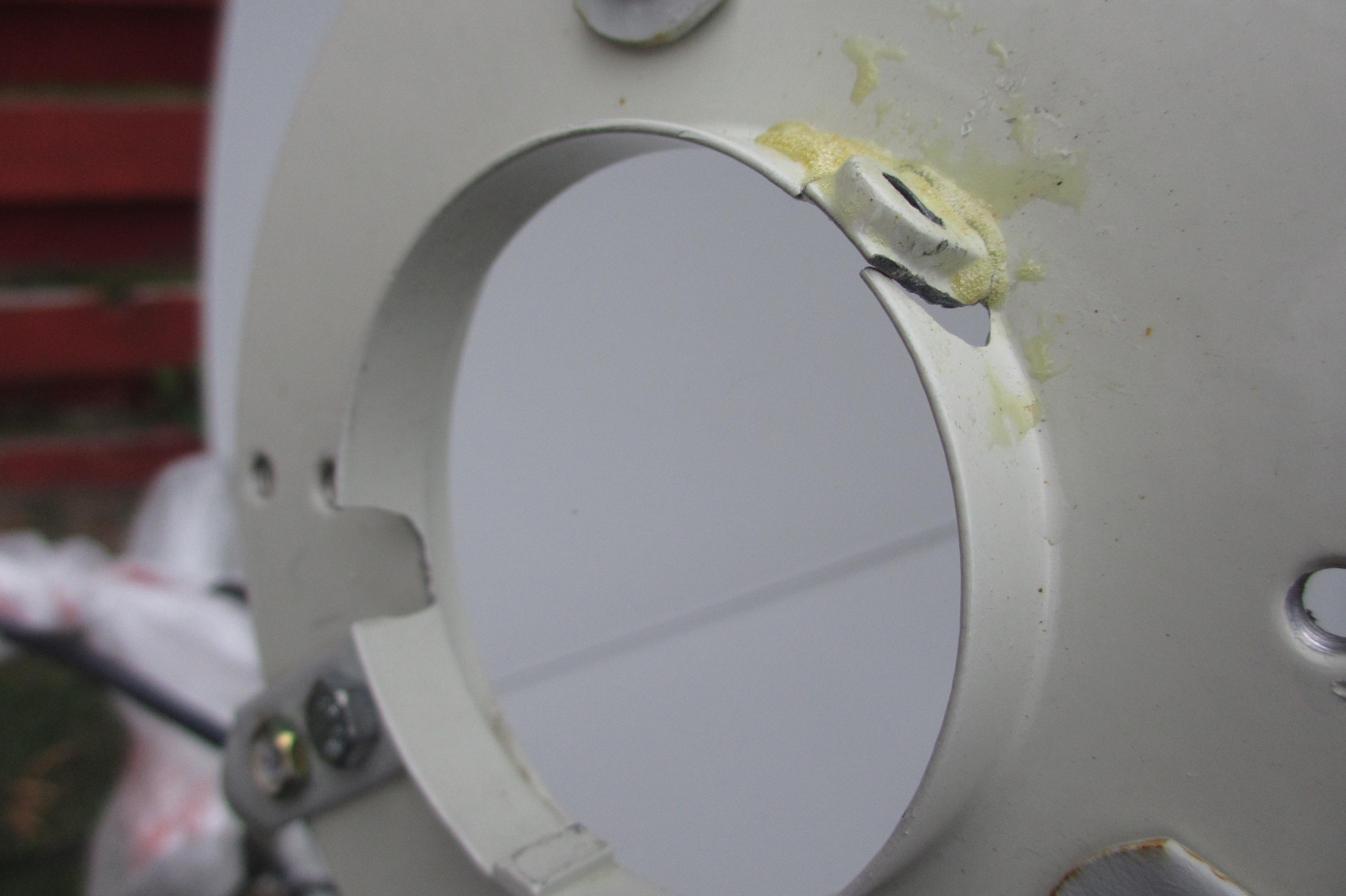

Yes, Here some..I have tried with Kola loca and the Strongest "El Gorilla" Glue and Nothing after test:(

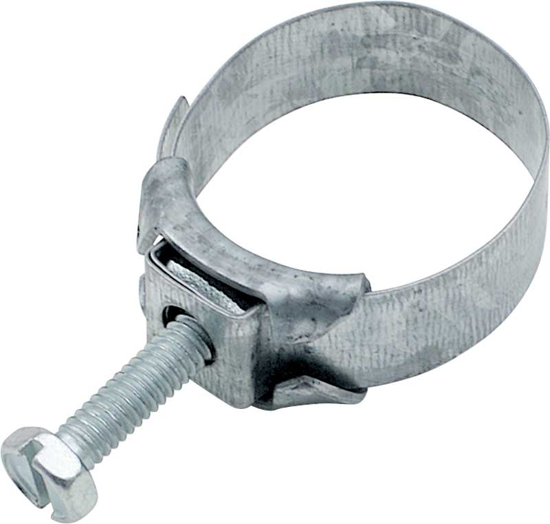

You need to think like an engineer. Imagine what you could fabricate for a repair after looking at something such as this:
This is known as a "Heater Hose Clamp". Just imagine fabbing two of these over each other with TWO opposing screws, placing it over the broken part of the collar-ring, and tightening it down equally and carefully... It might require drilling an extra hole or two...
I can't walk anywhere without looking at something, and imagining with a fabricators eye (translation: "Cobble-artist" hehe)what I can modify it into, or use it for a purpose for which it was never intended. Which makes my life harder, but more interesting! lol

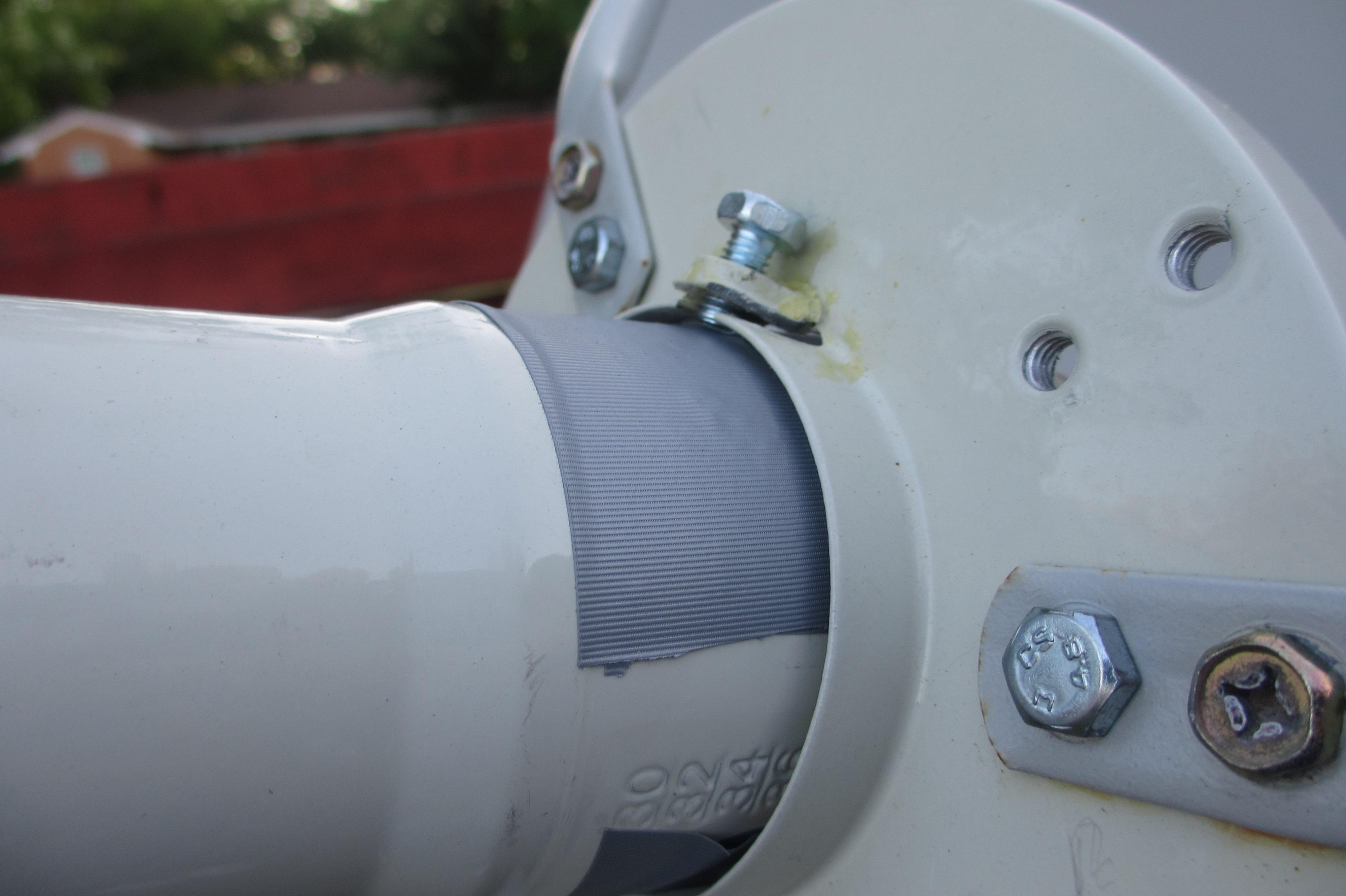

Once when I had a similar breakage, I bought a stainless hose clamp from HD - the worm screw automotive radiator hose type. Drilled a hole in the part of the clamp without the thread slots. Clamped it on the remaining part of the flange, lined the hole up where the tightening screw originally was. Put a little nut in there and a little machine screw through the hole and the nut. Tightened.

would try to drill a hole and use a self taping screw. test your hole size and screw on another piece first.
very little pressure will hold those lnbf's in place
