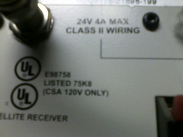

I cannot find the motor control amperage rating for a DSR922 receiver. The voltage is 36vdc, but cannot find documentation for the current.

This pic is from the back of a GI DSR 922, does that help?
First generation dish movers were all 36 volt. Then someone* complained that 36v is not allowed in class c wiring in the mid to late 80's. (Class C - low voltage/current - install without inspection - even by untrained homeowners) *Think it may have been Calif.(???) Anyhow, after threatened legal action, the mfgrs said enough, and anything after an agreed date(whatever it was) were only 24 volt.The maximum allowed under 'Class C'. Still remember reading the 'NOTICE' sent out by USS/Maspro (Doug Denhert) Anyhow, there were a few complaints after an 'upgrade', BITD, that their dish is a lot slower.
Got a couple 'early' movers in the museum. 36V @ 3 amp.
All the later ones - 24v @ 4 amps.
-Motors get less efficient at lowered voltage, which slows rotation, requiring more current.- Ya wouldn't think so, but it's true.
