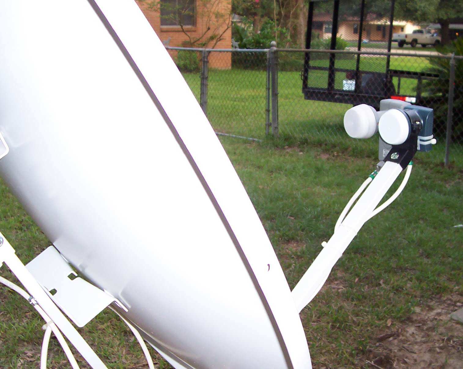

Ok.. I had time to play with the dish a little. I first tested the skew theory. It was already set at 0, moving it didn't help the results. I then tested the LNB arm out of alignment, I push the arm a bit with a plastic pipe, negative on that test. Next I check the plumb again, dead level. Next I barely pushed left or right on the dish, signals went down and returned when I stopped pushing. Next I pushed down on the dish, instantly my signal went from 40% quality to 70% quality, this was on 70 degrees or so satellite. So I changed the elevation bolts on the dish to drop it hair, I was at the 39 and now I'm at 38. I did remember the book saying to use 41.5 based on my elevation but that was too high. Next I slid back over to G10R and frowned when it stopped. It came up to 50% quality. Next I pulled back on the dish a bit to cause the elevation to go up a hair and boom 90% quality.
What should I change to get the elevation to stay the same across the arc? Should I try changing the angle from the 31.5 on the motor?
I finally had time to go back outside and play with the dish again. I slid the sucker down the pole about an inch, tightened, and levelled everything. I swung over to my TS sat, G11, and locked on a DirecWay's signal. I tuned everything and swung over to G10R, tuned, then swung over to Amazonas and tuned. I must have had the luck of the draw as it only took about 15 minutes. Most of the Amazonas transponders peg out the quality meter at 99%. Signals on IA7 also hit me around 95% quality. I couldn't be any happier. I'm having a ball with this system. Thanks for allowing me to use your signal DirecWay!

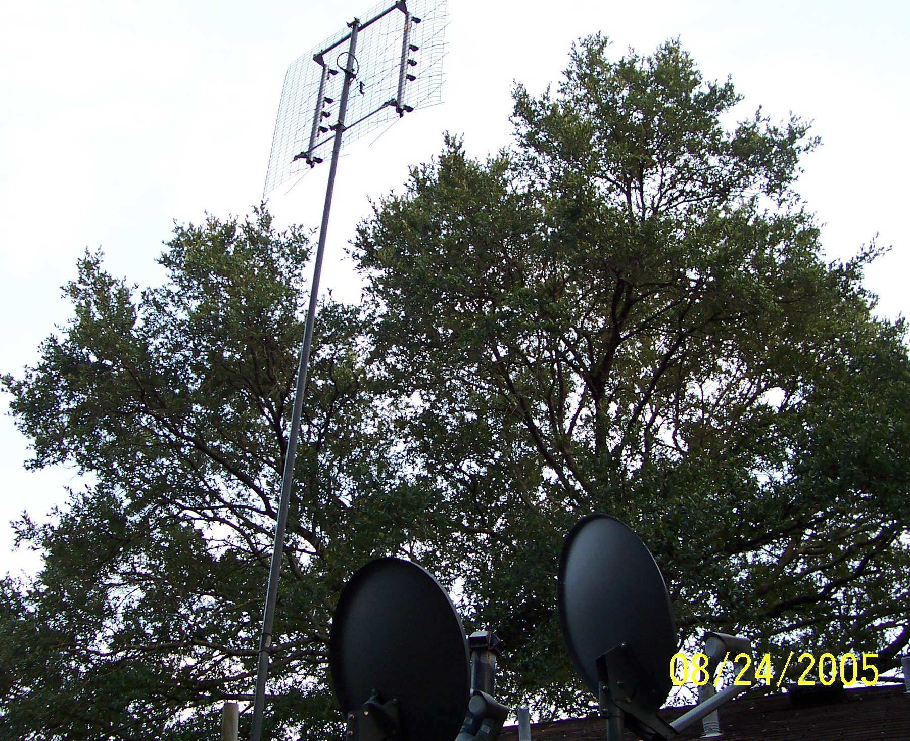

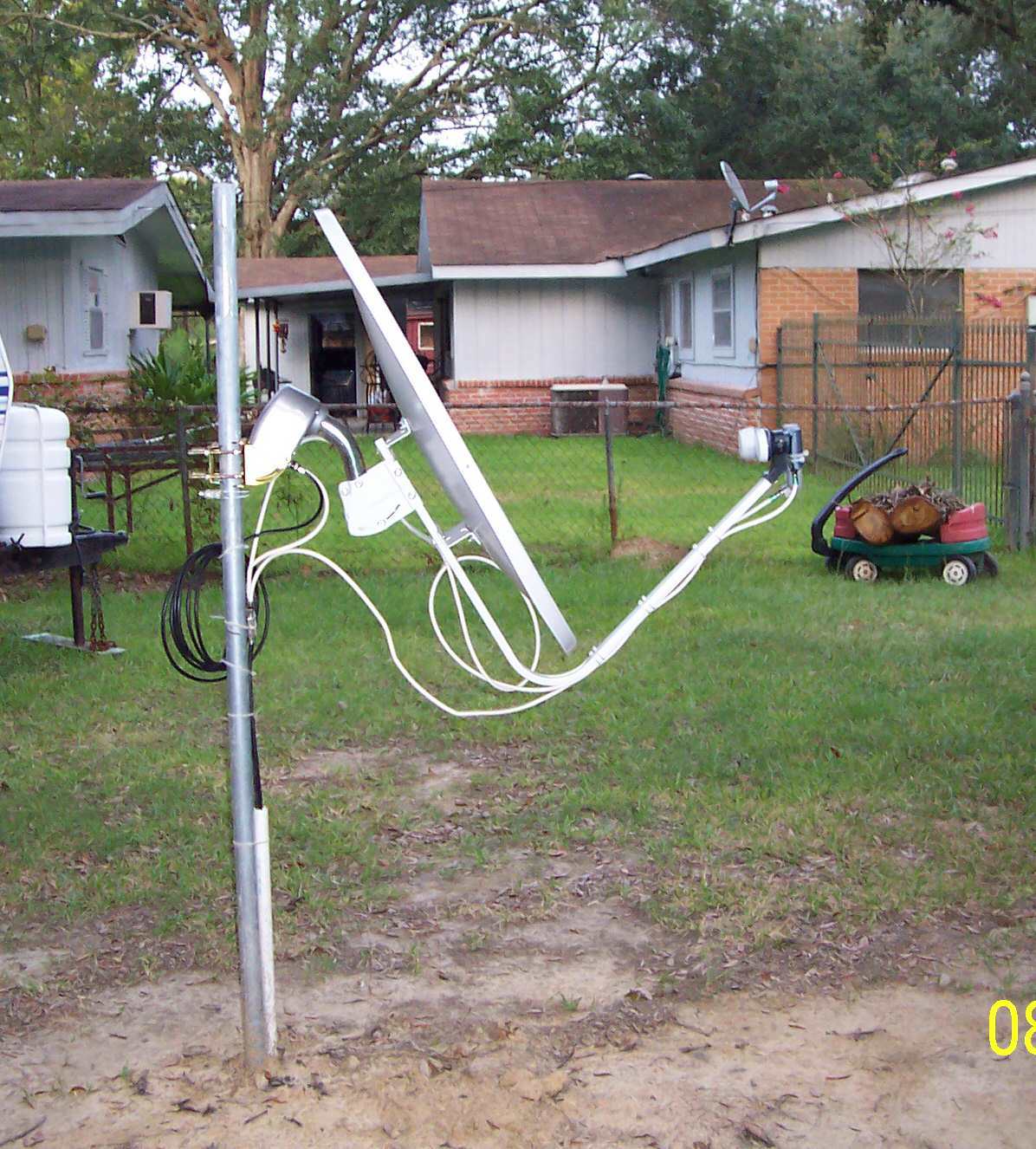

Here are a few misc pictures. Everything is working and needs to be cleaned up so pardon the mess on some of the pictures ;) It's always a work in progress!
I'll post comments on pictures as people ask about them instead of having to explain everything.
