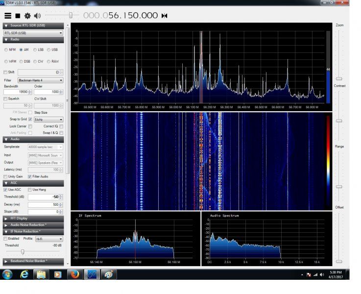

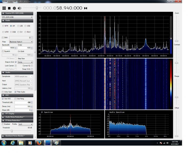

UPDATE: I call the electric company and i felt like i was getting the run around without know 100% that it was the outside power lines. So i bought a SDR (awesome, RTL SDR) and checked 54-60 Mhz with stock SDR antenna and found AM radio.Shawn Hannity, was on one station. No matter the direction of the SDR antenna AM radio still was Any thoughts would be appreciative.

Perhaps we need to start at the start. What stations are you trying to listen to or watch? You've started somewhere in the middle without laying any of the groundwork.
You're not going to find AM radio signals in the TV band anymore. What audio signals there used to be back in the day were FM and the video signals were AM.

He was trying to pin-point a possibly electrically noisy power pole using an AM radio as a direction finder. However, he seems to not have understood that Rabbit73 on the Tvfool forum suggested using an old school portable AM radio, that still has the old ferrite loop antennas for that purpose. I know nothing about SDR's, but I don't think they'll work for this purpose. Not that you can tell for sure from his reply above what he really discovered, that seems to be oddly truncated...

i have used an AM radio just not with a loop antenna, there are server poles that indicate power line noise.

maybe i am misunderstanding the SDR, but i can listen to AM radio in 54-60Mhz range.
