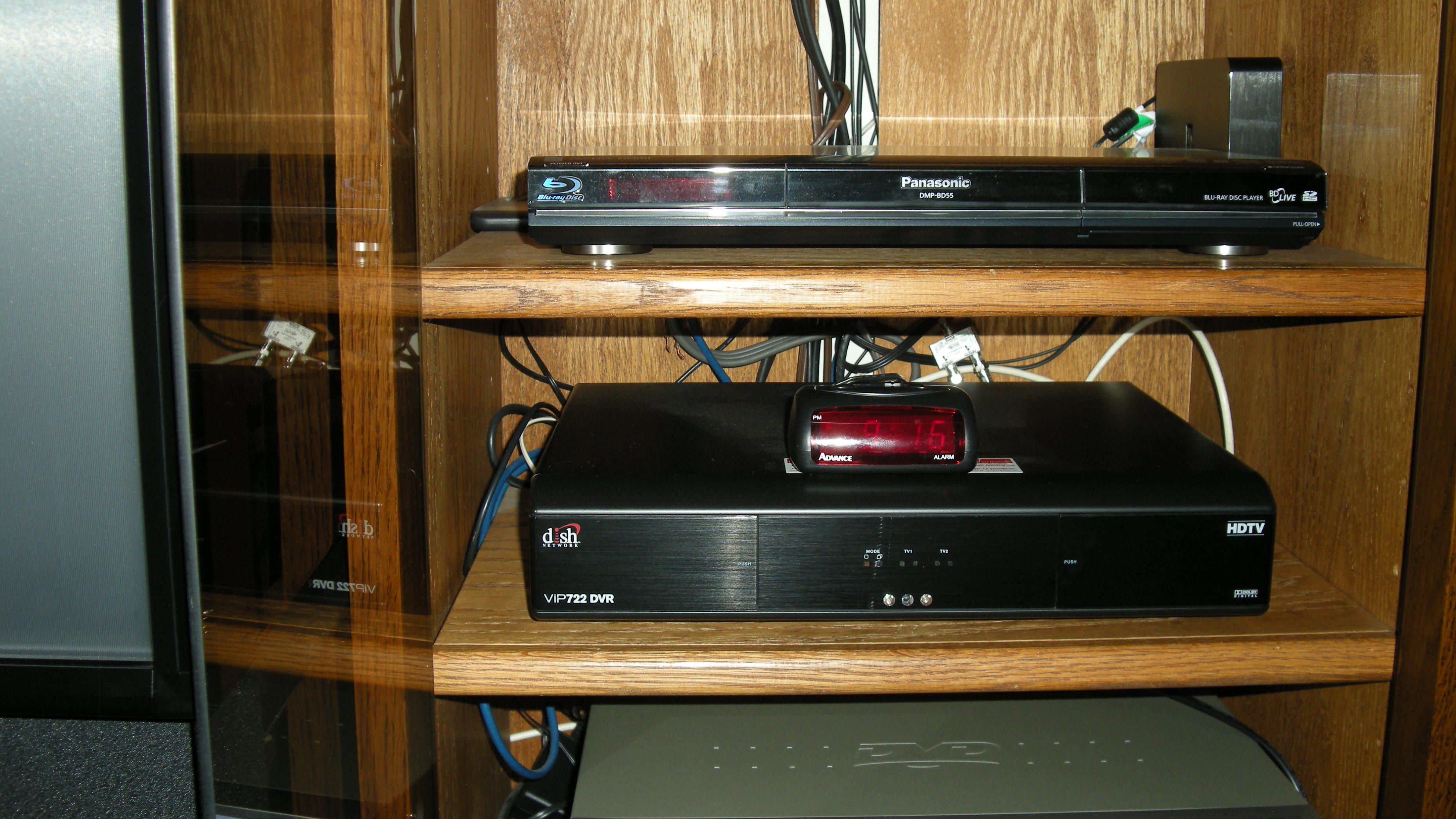

You are really so full of yourself, you lessen your credibility. I have had a 722 in a cabinet for 3 years, and guess what, I've never had a failure!

OK, you said "Maintaining "minimum clearance" doesn't guarantee "proper" ventilation! You can have 10" of clearance around them, if you stick them in a cabinet they will overheat." I said " I have had a 722 in a cabinet for 3 years, and guess what, I've never had a failure!" and included a photo of my configuration.
You maintain that you have to have external venting because that's what fixed it for you. I am disproving that theory because I have my 722 in a cabinet with some ventilation around it and I have never had a failure. If that makes me, or you for that matter, an expert on anything you have a different idea of what I consider an expert. You shared your experience with vigor and I disproved part of what you were saying. Get over it....
