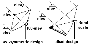

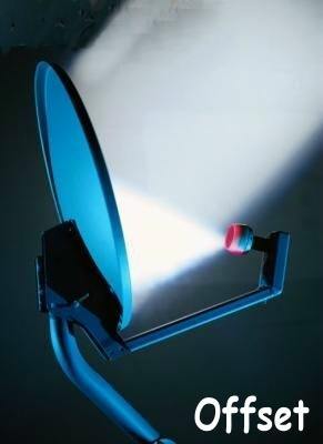

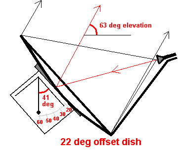

how would i go about figuring out the angle at which my offset dish receives it signal? is there maybe a website with a formula or something along those lines? i know there's a bunch of websites that tell you the elev, az, and skew for a particular satellite based on your lat. and long., but i was wondering if there was a way for me to figure out all that on my own.
