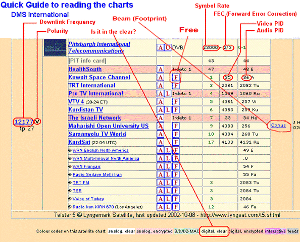

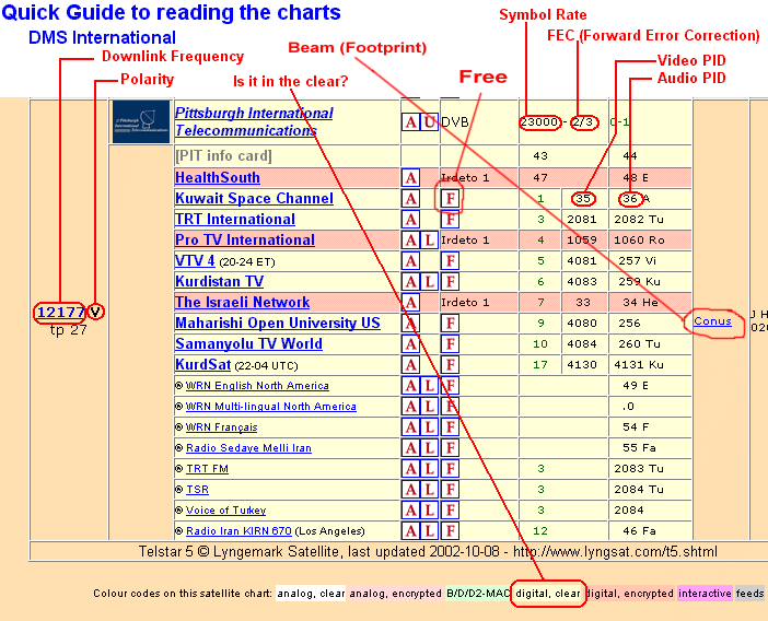

thanks guys what is on g3c anyways?? i live in newfoundland canada don't forget, i think that is why i am having so much trouble, plus using a 76cm dish..
If you are not in the footprint you will not get anything.
I would go through all the satellites of interest on Lyngsat, check the BEAM or footprint and only go for satellites that you have a chance of getting :(
May be an idea to add your location to your member profile!
Dang old footprints!
