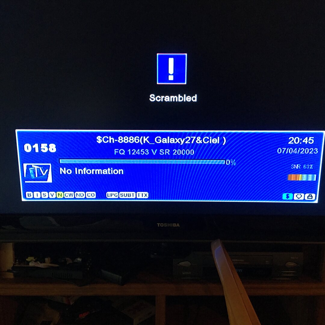

Something Weird happened this morning while using the Openbox 9 to write down info from the screen to try to find them on lyngsat DOT com:
even that all channels listed where labeled $ (scrambled) the screen started to show the channels perfectly and I am sure those where encrypted channels. I must done something with the remote without realizing. Any ideas?
UPDATE: just went to check those scrambled channels and they are now scrambled !!!!!

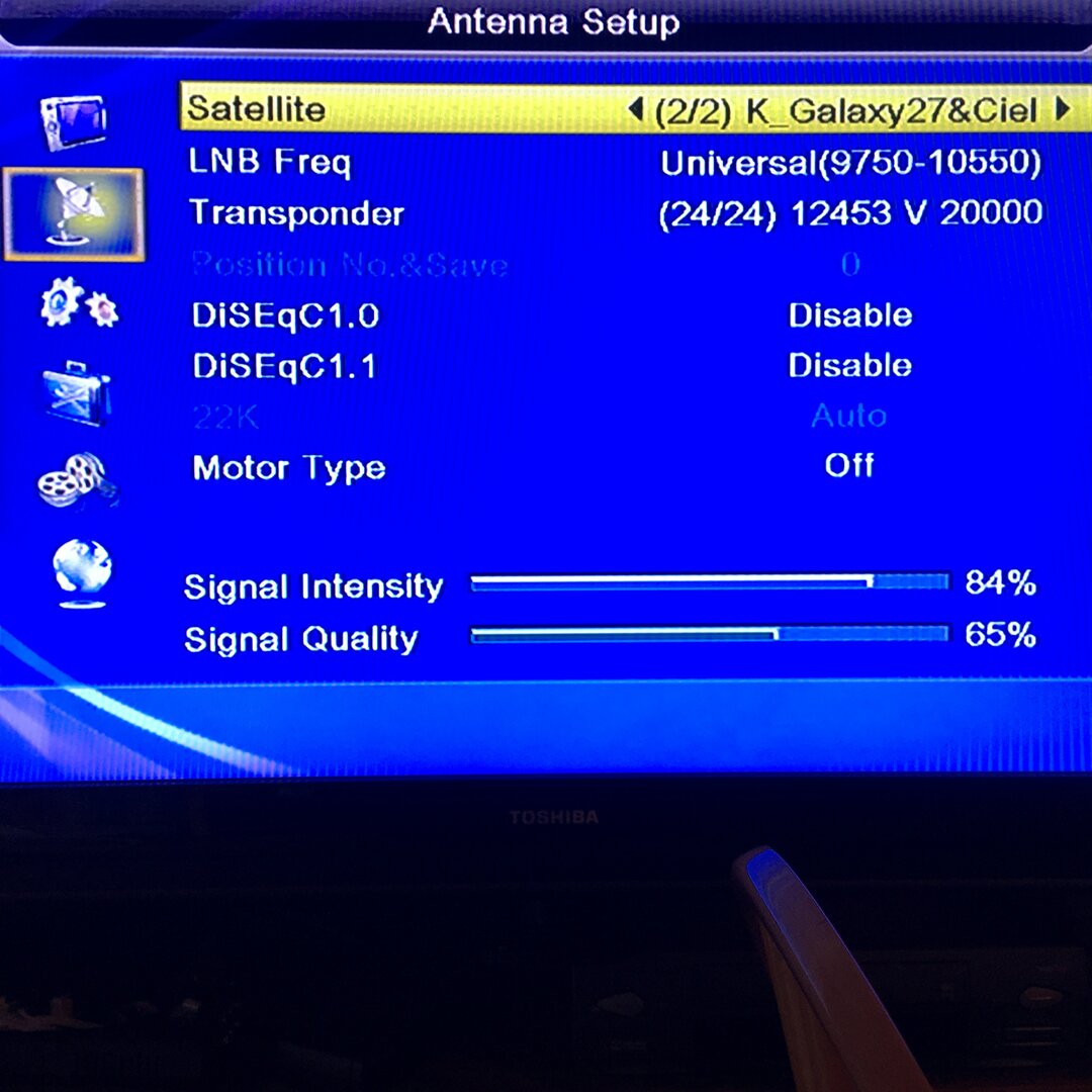

can you post a list of those channels that scan in, as well as the associated frequencies, polarity and SR? I'm think you're getting some Dish Network stuff, either from 119W or from 129W (or 121W if there's still anything there... not sure)
Reactions: electronmini
Thank you very much for your time andyour support, I in Word for pasted all lygsat files from 117W W to 129W so I could easily search for a frequency like 12453 V that sown on my recent scan for transponder 24/24 12463V as per pictures attached.
I have all those files as docx that is easy to search for text.
None of those from 117 to 129 found any:"12453" What am I doing wrong?
Is there any way of parameter to identify the satellite by looking as those files?
Thanks

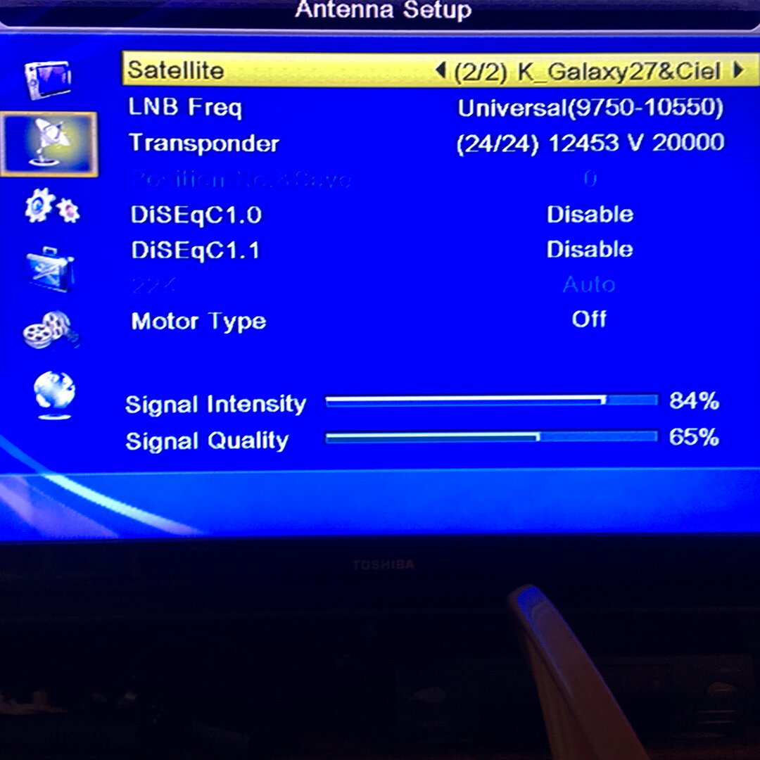

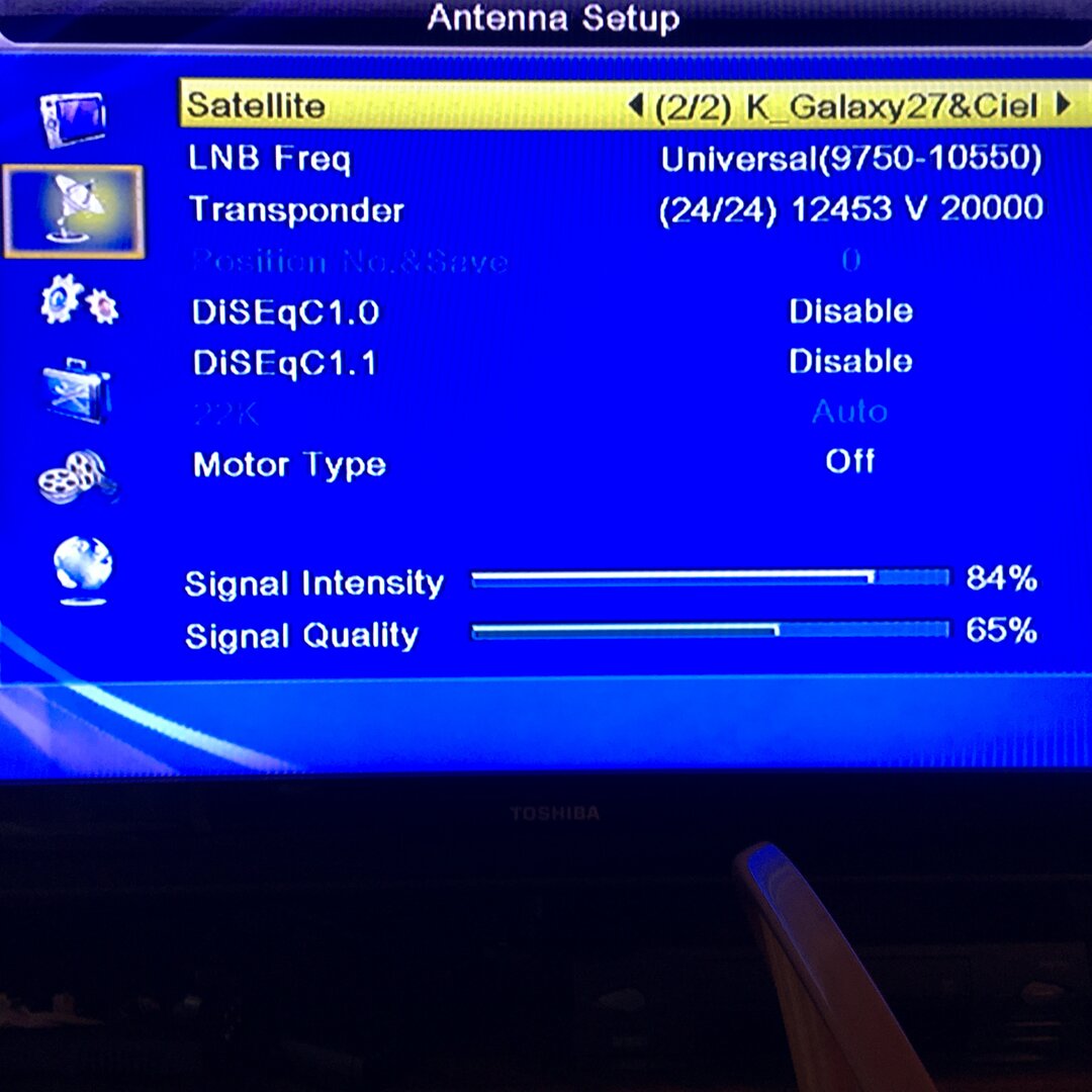

Is your LNB really a 9750/10550? 9750/10600 is more common. If you have the wrong local oscillator frequency entered, the transponders will show up as the wrong frequency.
Based on the channel name scheme and the Nagra light being lit, you're on a Dish or Bell satellite.

Thanks Jim S. :
Rainy day here today and I cannot find where I wrote a week ago the specs for the LNB. I will look it up as soon as i feel it is safe for me at 83 to get on the roof and read specs again.
But it is Fortec Star dish ( Believe it is 39") and is the same LNB that I have used about 10-15 years ago here in Texas on the roof and was receiving well (But I cannot recall what I had used for at that time. I gave it up after I found PBS Austin KLRU FTA with just my rabbit years antenna to the flat screen digital TV). The BIG dish in my avatar is deceiving now, since I was using it for C band in Ontario-Canada until about 10 years ago. Just now back in Texas-Austin area.
Would it be a reasonable idea for me to enter a few transponders with frequencies closer to the PBS stronger transponder? Which by the way; where I can find where are those specs for the strongest transponder for AMC21? How to search for that info this forum? I am al little/plenty rusty on the forum probably because of age.
And I hope I am not hijacking this thread but occurred to me that if I could find a good book and FTA Satellite setting and usage will be best time spent to refresh what I probably knew 15 years ago. I need to regain definitions for all the abbreviations and parameters utilized in satellite parlance to avoid loading people with silly basic questions. Any suggestions for a good book or maybe a comprehensive thread somewhere?
Thank you very much for your time and patience, I always admired those that had the knowledge and attitude dedicating their time to help other.

I just copy the LNB sticker and has this:
FORTEC STAR
UNIVERAL SINGLE LNBF FSKU-V
R.F.: 10.7 - 12.75 GHz
L,O.:9.75/10.60GHz
N.F.:0.3dB
S/N:5K201193s
Which numbers should I enter on the OPENBOX 9S?
I changed to 9,75 - 10.60 and keep getting the same scrambled channels on Blind scan

Thanks for the info. I was not able to identify the one on the screenshot.
a few things...
- Now that we know that your LNBF setting was stilghly off, can you correct it to 9750/10600 and scan again?
- can you give more examples of channels that scan in, with the frequency, polarity and SR?
- particularly if there are other frequencies too
- I don't think that you are receiving one of the Canadian satellites as they would probably not cover down to Austin TX.
- when checking frequencies, just be aware that it's not uncommon to be a few MHz off compared to what's posted on Lyngsat or others, so an exact match is not required. But it should be close (I'd say +/-10 MHz).

If corrected to 10600 from 10550 it would mean that 12453 would now be adjusted to/scan in as 12503, and suspect he is getting spot beam 21 on 110W, but need channels/transponders information to confirm. The only transponders from the Canadian satellites that would scan in are from F2 - 111.1W (G1 - 107.3W transponders won't scan in) and they are all in the normal Ku frequencies (11700-12200).
Thanks, I just corrected to 10600 and took note of transponder 23 parameters to compare with the blind scan I am running now.
Glad to learn that the frequencies would not match exactly, I was always under the wrong impression that it would march perfectly. That maybe explains to me why when I tried to identify a satellite using the scanned frequency and lyngsat listing nothing showed up.
Is it the any other parameter for a transponder or channel on a satellite that would show up exactly as listed by lyngsat?
My reasoning was that if I can exactly know what I am looking at; then by a listing of adjacent satellites using DishPointer I could easily interpolate what correction was necessary to move to the 125 AMC21.
How do you calculate youe example above from the change 10600 and old 10550?.
Is the change a lineal proportion in percentage from the oscillator changes from the 10550 to 10600?

What is the transponder(s) parameters you are getting, and a full list of the channel names you are getting? This will help us determine what satellite you are on.
Keith: Thanks. Just scanned and 292 Channels all encrypted
41 transponders total with some of them details as follows:
Tranponder # Frequency Polarization % SIgnal strength/Quality
Tranponder # Frequency Polarization % Signal strength/Quality
1 11780 H 30000
5 12503 H 20000 85/70 strongest
26 12094 H 20500 86/46
38 12023 V 20500 86/60
41 12548 V 20000 85/60
Mostly the other transponders are weak.
Also gets 178 radio channels
TV channel labels goes from $CH-391 to $CH-8484
Channel 46 on the list labeled $H-7521 H 20000 PID:5410/5411/57
How can you determine the satellite based on that info?
Tank you.

Not sure how I missed that one on 110W when I searched earlier on Lyngsat
Electronmini, we look at the tables on lyngsat, first for the frequency that matches, then since those satellites have spotbeams, we look withing the transponders that use that frequency, we look for a beam that can be receivable in Austin TX. In this case, 12548 has beam 22 centered on San Antonio (good coverage maps are on satbeams.com). and on Lyngsat, if you click on DishUSA you get the list of channels, and sure enough there's one with PID 7521. So it's a bit of a detective game, and sometimes some programs are not listed (like the 8886 you had on the screenshot, it's not on Lyngsat)
One more thing, with the exception of 119W, those procrams that scan in as $Chxxxx are typicaly on frequencies above 12200 MHz
The other transponders that you listed (12023 and 12094) are likely some Shaw Direct transponders on Anik F2 @ 111W. Most FTA receivers can't scan those, i'm surprised yours actually detected them.
When you had Canal del Congresso that was likely 117W (Eutelsat 117WB on it's Mexico beam)
As far as using a meter, I think in your case it would be useful. I know nothing about the useability of the specific model, but I think it's basicaly a receiver and screen in a small portable package. Would be the same as bringing a receiver and TV on the roof, just a lot easier :)

Definitely 110W (12503 and 12548) and 111.1W (12094 and 12023).
11780 H 30000, you don't list any signal strength, are you getting it as well, or is it leftover from a previous scan?
