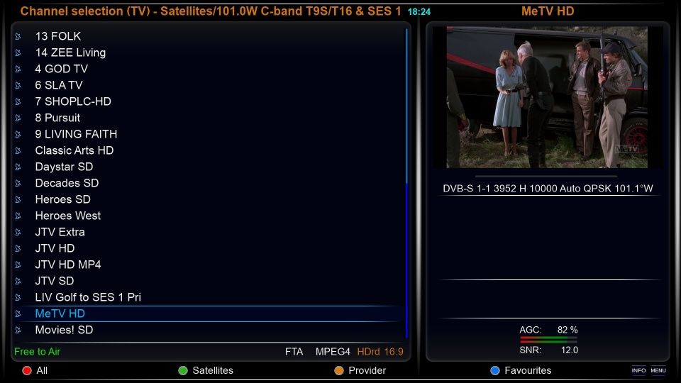

Same for me here. It's been up every time I've checked. Watched my usual Saturday night shows last night. Compared to the readings I got on May 4th, the SNR is down .8dB on the 8ft dish and is now at 10.0dB. The 10ft dish is down 1.3dB and is now at 12.0dB.
