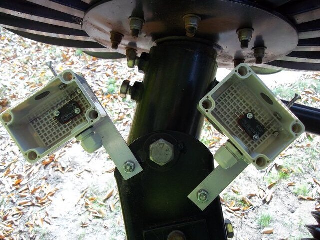

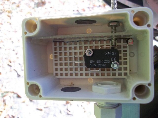

I have the limit switches constructed and installed. The pictures show the mounted boxes without the wires installed yet. I finished this afternoon and they actually work. There is a clear piece of plastic hot glued inside that helps support the ss screw that comes through the box. I have a small piece of an inner tube that the bolt goes through and is epoxied to the outside of the box to keep water from getting inside. The dark spots are pre-drilled holes that I filled with JB weld. The grid in the bottom of the box is not removable and did not cause any problem. Operation is rather obvious. The back center plate of the dish pushes the screw into the micro switch and dish stops. Not as good as my other actuator that the manufactured built one inside, but this should work.
