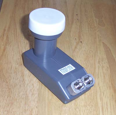

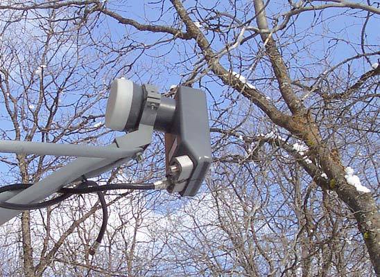

Here is the Megasat MS1075 on a table and mounted on the 1 meter dish:

I liked it for the rectangular base. Easily used on old DirecTV Phase II and III dishes for fun experiments.
Can be held by the neck as shown, for standard FTA mounts.
They also sell a circular model MS1125, rated 0.4db, which might be of interest to the Alaska, Puerto Rico, and Mexican users.
