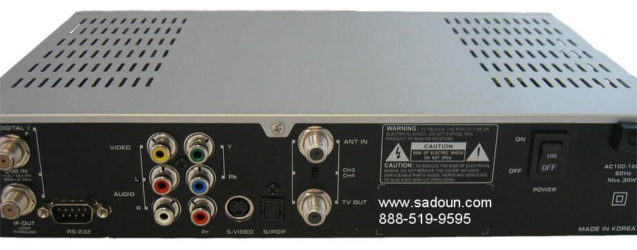

Here is a back picture for the Mercury II. TV Out is where you hook up to your TV
