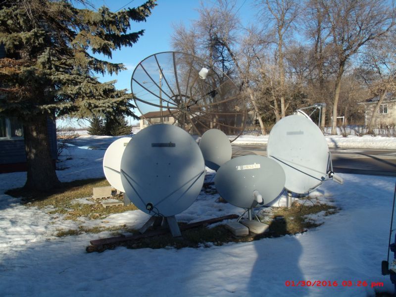

i'm one that prefers not to do Ku on a BUD. (UNLESS, you have a commercial BUD that's rated for Ku, That is) Tracking is Critical as the beamwidth is a fraction of 1°. The accuracy of the parabola is Critical, in all planes. (So yeah the curvature is both dimensions. not flat across the ribs) Seams that all I've read is the performance, at best, is comparable to a 90cm in most highly tuned systems. Only slightly better in only a very few.
But for convenience of operation it has it's advantages. But for performance of operation a separate motorized 1.2m would be the way to go IMHO.
I motorized a .7m with the BUD and didn't miss much. Reason, the mesh on the dish isn't Ku friendly, holes too big. Recently replaced with a 90cm..
http://www.satelliteguys.us/xen/threads/how-i-made-a-c-only-bud-work-on-ku.241465/
