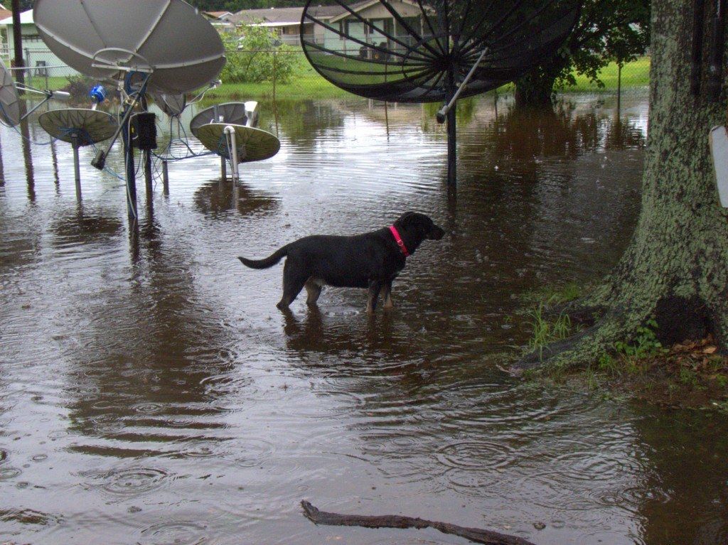

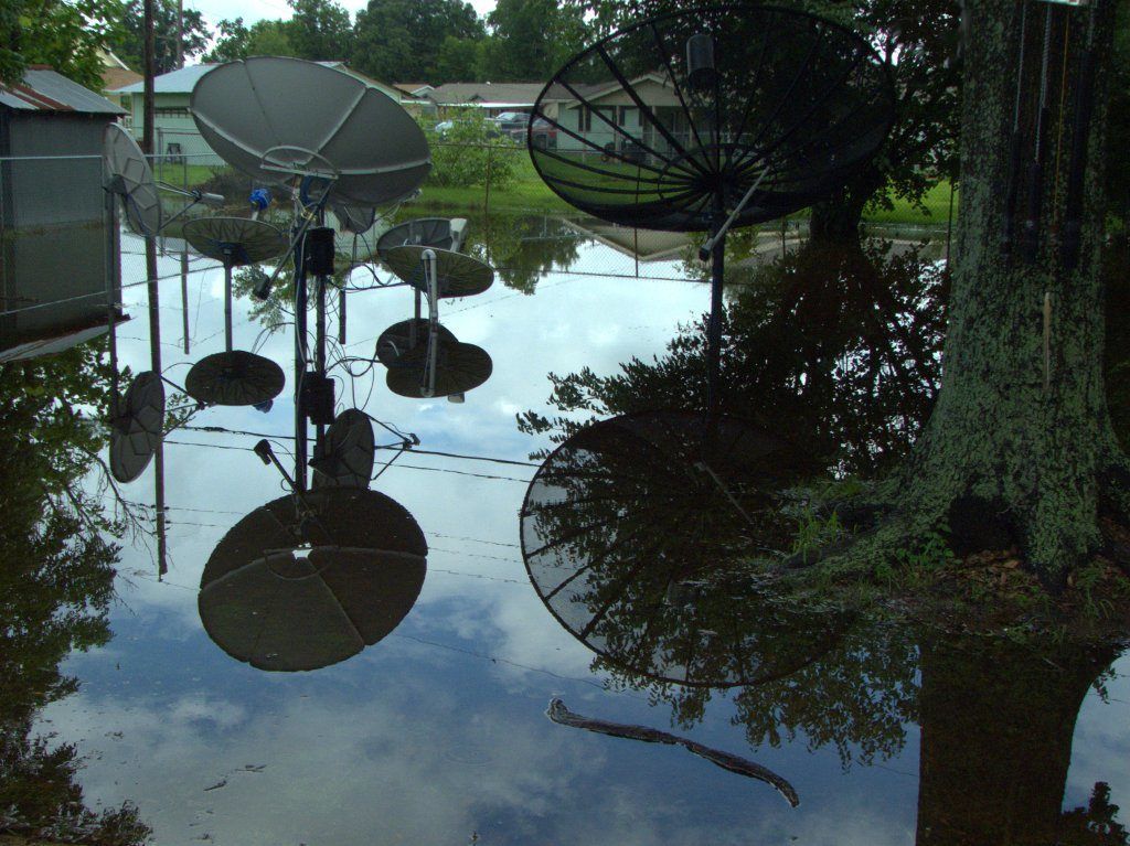

I have seen you guys say stuff about the ground reflecting noise into the lnb. Ok, I think I kinda know what you are talking about.
Let me pose this loony question then. Right now my yard is literally a lake. It's flooded and 6" or more deep in a lot of places. Underneath the dishes is 100% flooded.
The dish is mesh. Could there be "noise" (whatever that might be composed of) being reflected by the water into the lnb through the mesh of the dish?
Could my yard being flooded have anything to do with this?

So much for the drought, at least here.
