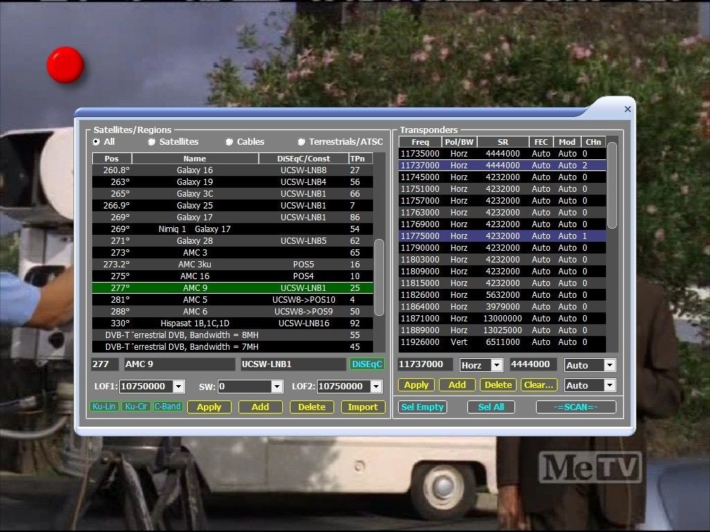

I hooked up the coolsat in the middle between the dishes and the pc. When I turn the coolsat on the pc loses the signal so you can not have both on at the same time. I did a blindscan of AMC 9 and the numbers it found match the numbers in the pc.
However, I have found in many, many, many instances, that the info I find online to enter into the editor is off by several points.
I am starting to wonder, could that be because my dish(es) aren't aligned properly? Would that cause me to have different numbers than the websites list?

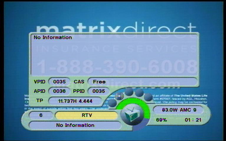

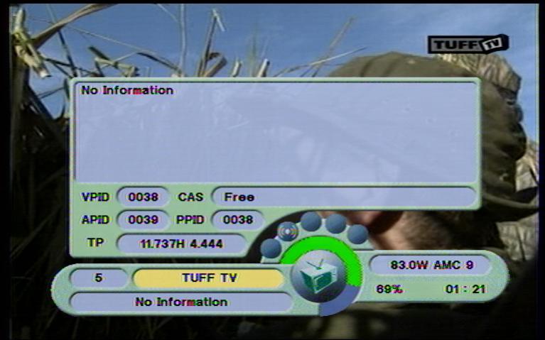

Here (attached) for instance is what my coolsat found for RTV and Tuff on a blind scan.
In the theater app on the pc, those channels have the same numbers as the coolsat found on a blindscan.

The different numbers are probably due to the local oscillator frequency of your lnb or lnbf. Nothing to really worry about. Your problems sound like a software corruption or a failing piece of hardware, such as your tuner card. I would think the software is the most likely candidate. Do you have what you need to restore or reload the MyTheatre application and database?
