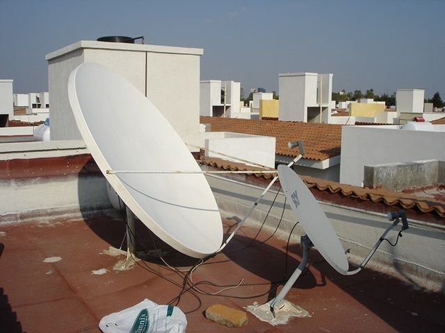

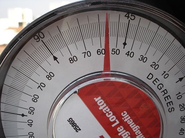

Hello. I am not an expert, i have a 722k and have no channels.
It was working with a .90 meter/3 ft antenna, then I tried to align a bigger antenna (1.8 meters/6ft) but I can't lock the sat. Do I have to know a tip or a hint?. Should I point the antenna more to the right or to the left or up or down?. Is the new sat at the same point as the old?.
I don't want to call an expert, I would like to do it myself but I don't know how to make the alignment manually, I don't have sat finder, just my hands and trying and trying. Wich transponder should I look for?.
At Irapuato, Guanajuato (central México) my readings at 10:40 pm with the big antenna and without clouds are:

Big dish
Thank you Iceberg, in fact I used the big dish already to get 110 and 129, but I want now the 119.
Do you know if there are blueprints or graphics about the design of dishes?, maybe is not well designed the dish.
I will spend tomorrow's afternoon looking for a better signal, now I just have some ESPN's, and CNN.

I suggest you get an 8' dish so you can use it to get 110 ans 119 with a multilnb holder, you can find them in jalisco pm me if you need some help
jiar75
from the pic of the dish it looks like the LNB is too far way from the dish. That results in poor reception numbers
LNB position is correct remember is a big dish and it has to be in proportion
I'm fully aware its a big dish....I work with them too as per my signature
What I'm saying is from the pic since I cant blow it up bigger it looks like the LNB is about 3 or 4 inches too far out compared to the dish unless the LNB truly has to fit in the end of the arm of the dish
