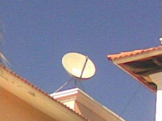

Can you post pictures of your Dish 500 dish in Cancun? I don't beleive you.
Kind of challenging in tone, no? It's a 1.1 meter dish, probably DirectTV surplus. Note the screen shot of the Pointing Screen. It says Dish 500. Sorry for the cell phone pix.
BTW, why don't you believe me?
It's probably your reference to using a Dish 500. That setup utilizes a much smaller dish. Your receiver is just interpreting your setup as Dish 500. The receivers don't always know how to label our MX setups, but they do the best they can.

Since I'm out of my depth here, can you tell me the dish type I have by the picture. It's about 1.1 meters in diameter.
I don't think DISH has a marketing name for your setup.
I would just say that you have a 1.1 meter dish pointed at 119. If you can provide some additional info about the dish you could throw that in. Does it have a name on it? If not, and you bough it locally, it was probably made locally. That can be useful information to add in there as well.
Also, if you can identify your LNB you could add that. It should have a name on it.
thats not a Dish500. The settings in the receiver just say that. When I had to set up a 322 for my dad to replace a 311 I set it up at my house temporarily and I used my 4 foot dish (because it was the closest dish I had handy) here in Minnesota (where a D500 is all we need) and it still showed Dish500 in the settings even though I was aimed just at 119 too
Thanks, Iceberg. As I said, this isn't my area of expertise. I took a closer look at the dish from a neighbor's house (getting on to my roof involves 3 very long ladder climbs). There is a faded DirectTV logo on the dish, so I assume it's an old DirectTV 1.1 meter dish with a Dish Network compatible LNB. I couldn't see any markings on the LNB. Obviously, setups here in Mexico, especially 5 years ago when this was installed, can be a bit improvisational.
