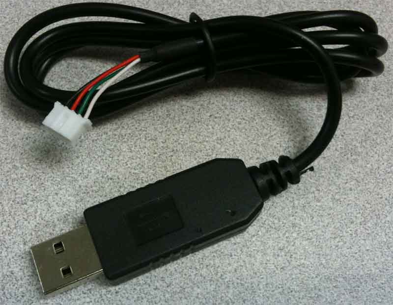

Just received and tested the TTL/USB convertor cable samples manufactured by Wallyhts. Works great and nice workmanship!
The connector fits the header perfectly and the .abs and .udf files transfer perfectly! Great Product!

<img src="http://www.satelliteguys.us/attachment.php?attachmentid=81299"/>

Got the cable today micro is working again.This is very easy fix with the help of the good folks at Satellite Guys.Plus a very good seller to send me the cable.Tried to send bad udf file but was refused by my email. THANKS EVERYONE

is this solution simply putting on a connector on a usb cable? if so i have the connectors, cables and a soldering iron...? charlie
No you have to have one that has the proper built in chip and circuitry.
