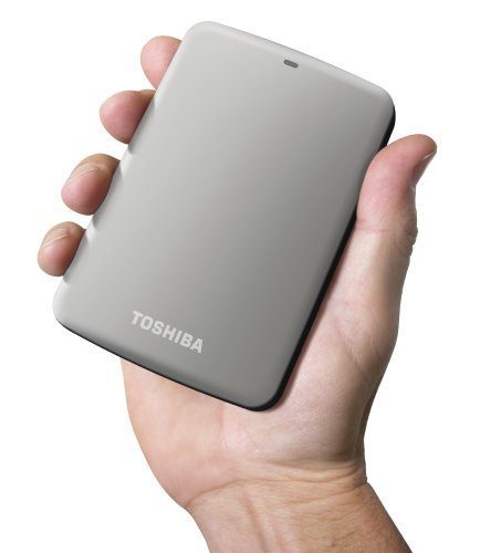

With my microHD, I'm currently using a Toshiba Canvio Connect 2TB drive - HDTC720XS3C1 - that I got on sale from Staples a few weeks ago. No external power needed. The drive powers down when not in use, so there is a 7-8 second delay when it comes out of 'sleep' after you hit the RECORD button. Haven't had a chance to record any high high bitrate sports feeds, only thing close are the network CBS 4:2:2 (garbled) and NBC feeds. No hiccups when I play the recordings on my PC. My only peeve is that the microHD splits the files into ~1gb chunks and I haven't found a program that perfectly combines the files without losing video frames.
