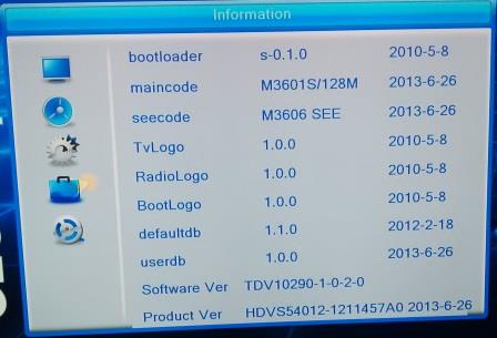

MicroHD S/W version
OTHER GeoSatPro HDVR1200
