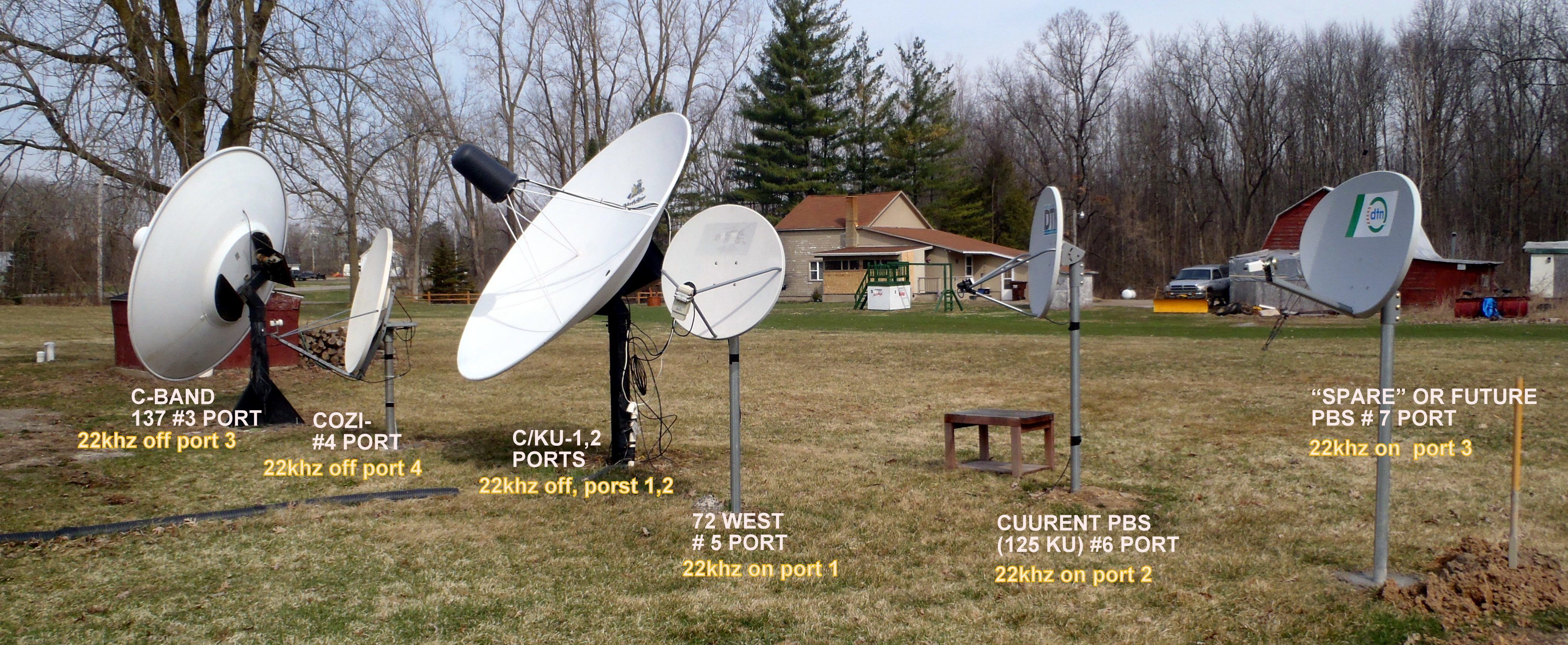

Well, "at the end of the day" literally, I'm back where I started. My satellite compliment shown contains a combination c/ku feed on the middle Birdview with the black nosecone. It's been operating with a 22khz switch, one side taking the c/ku along with 2 other dishes via a 4-place diseqc, the other side of the 22khz going to another 4-place diseqc. Not all the ports are used yet, but we're getting close. Picture attached, White lettering shows 8-port settings, yellow shows original settings. (and one mis-spelling of "port" not worth re-doing.)
I have had an 8-port diseqc I've wanted to install and the weather was nice yesterday, so I went at it. Replaced two older cables from the Birdview c/ku with more efficient ones, and thought an 8-port setup would simplify things As I hooked it up, however, more and more problems developed.
After completing the hookup, using the highest selections on the MicroHD menu for switching (first 8 selections of the 16-place switch) I lost some feeds and thought maybe I had lost one of my voltages. I had intermittent reception on 137 West from the fixed birdview, it would pixelate and freeze, followed by "no signal" screen. I thought maybe it was a lack of one voltage affecting only vertical signals, then I realized I was receiving PBS on 125 which is vertical. Then, I wondered if the switching of C-band vs. ku was reversed in voltage or different somehow. No time for wondering, however...I wanted reception restored by evening.
Finally, I put back the original configuration, wires hanging below the Birdview, all tightly checked, and STILL it was intermittent. New ends were put on where connections were suspected. Then...it hit me! The LNB voltage may have been a little low!

BTW...I re-tried the 8-place switch, and it totally failed, no signal, period, using positions 1-8 (of 16) on the last of the disceqc 1.1 menu for MicroHD. Gave up on it, I'm back to the original 22khz and 2-4-port switch arrangements. Even at that, something is NOT right, like I have a lazy LNB, or a switch problem.
I can get horizontal and vertical channels, but some are acting VERY odd.
On the microHD, when "bumping" the dish, the signal disappears for that brief second. That's normal. Now I have one channel (Ebru) where the signal is THERE DURING the bump and GONE when you rest the dish. Either I'm between clicks on the sensor, or that is a mighty tight beam..but it used to do fine! The Microspace Ku's are fine.....All Ku is on port 2 of the diseqc, off the "no 22khz" side of the the first switch. I don't know if I should changeout my 741 c/ku LNB for the spare Geosat, or whether I've got a lazy switch somewhere in the mix.
Since I can get both horizontal and vertical with the "clunky" setup, I have to believe that the first diseqc is fine...but WITHOUT moving the dish at all between hookups, and going back to the original configuration, Me-TV was reluctant to come in until I'd changed channels a few times!
I'm COMPLETELY lost now, but lost WITH most of the system working. I think maybe the lower voltage may have done some damage somewhere, but I have no way to prove this, short of swapping it out.
Either way, a new power supply is coming to quiet down the noise from the MicroHD....
Got any ideas on the finicky signals? I'd have thought restoring the original settings and switches would have been "instant success" but it's acting more like a tube radio than a solid state modern device!

For an additional test, I just tried the Geosat LNB (c/ku) with zero results. I put the original DMX741 back, and can get horizontal and vertical channels on various satellites, through C/Ku port (1 and 2, 22khz off) and through port 3 (C-band fixed) and port 4 (125 west fixed)...but only after switching channels and polarities a few times. Now it's steady again. Nothing on the former functioning port 1 of the other side of the 22khz switch. (72 West NBC feeds and occasional weather channel.) Not sure if that's even active right now.)
I noticed the switch you recommend is different in graphics than the one I had....Mine was labeled diseqc 2.0, that one is labeled 1.1. Perhaps my "8" is wrong! It's the DMS international DS-7881.
I'm also going to check any "slop" in the birdview's mechanism! It could be that by coincidence, we're not hitting ON the birds until we start back UP from the bottom through the arc with the weight ON it....and the main satellites I go between are only a couple degrees apart and easy to miss.
Will probably put the Ebru feed on a dedicated Ku dish next so we don't have to swing to that one....
If I had enough C-band dishes, (got all the room in the world) I'd ditch the motorized system in a heartbeat!

Just for clarity before making changes...I'm currently still running the 22khz first with "off" side feeding 4-place switch with the following: Port 1: (moving) C-band; Port 2: (moving) Ku, Port 3 dedicated 137W C-band, Port 4: dedicated 103 Ku.
The 22khz "on" side feeds another 4-place, with Port 1: dedicated 125 West; Port 2: dedicated 72 West. I've not had stability on PBS for about a month. Just this evening, I re-programmed the PBS feeds away from the fixed dish and back onto the moveable c/ku birdview dish and signal is stable. Will leave it there. But, I'm "maxed out" for a 4-place switch without using either a 22khz/secondary 4-place, or the recommended 8-place and would like to be able to add (2) more fixed Ku dishes to this system.
Perhaps the MicroHD cannot handle growing of the "farm?"

Well, after a few days of experimentation and testing, It seems I cannot blame my switches for any (lack of signal) issues!
I ran straight cable to the microHD today, all C-band channels switched quickly and efficiently. Ku worked fine when sent straight from the combo c/ku LNB
to the receiver via it's own cable as well. Sats were already programmed properly in the MHD so all the settings were there. Then I tried simple 22khz switch vs. the 4-way diseqc. inline to my dish farm. NEITHER could pass signal. This gave me the feeling the receiver may not be able to output proper tones to the LNB for polarity switching, and for the ports needed, or that we had a random element in play.
I have a friend's older Openbox S10 here, with software he claimed was stable, so I put that online, using the pre-programmed locations in my positioner, and hooked up the diseqc. The Openbox was able to do the switching just fine for c/ku and for horizontal and vertical channels, thus I conclude we have a power problem on the microHD with regard to consistency. This could explain why it's been taking "time" for some channels to appear after a reboot, and why the occasional power cycling wwas necessary to get channels to show on the MicroHD. I was operating the MHD with a 2.5 amp "repair bench" power supply to make sure there was enough current to run the receiver, in case the wall wart was dying.
So, for a few nights, until the next hamfest makes me some bucks, I'll be running on the Openbox, hoping I can purchase a new MHD when they're again available through proper channels recommended on this site. Programming it seems a bit clunky, but I'll get all my channels in soon, and I'm grateful to have a "backup" receiver.
Not sure if it's worth sending the receiver for repair or not...but I'll look frequently to see when a new one can be ordered.
SatAV has offered a replacement original power supply. We'll see if the "oomph" that should be provided to this little box, when restored, will get us back on track! A generous offer by the company. Let's hope we can get all six dishes properly switching again!
