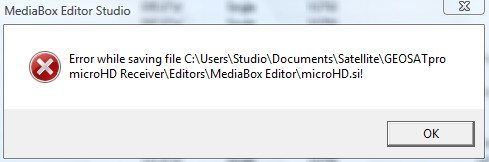

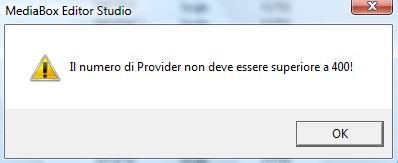

Only problem experienced so far is trying to save a newly created list to .si file type from an imported file. Following errors received, therefore save was not successful.
The compiled list may exceed a parameter of the .si format. Export and save the file back to microHD STB type.

If you wish to play with the Mediabox Editor studio beta software, here is a quick work around for the MES 400 Provider limit save error that is preventing the file save in the .si file format.
After importing a file, delete the Channel list and the Provider list then perform the same file import a 2nd time. The second time the import is performed the Service Provider list propagates correctly. Currently, MES is incorrectly creating a separate provider listing for each channel during the first import instead of assigning a provider from the list to each channel. With the sample file, the Provider list is propagating with 439 providers instead of the correct 46 Service Providers.
