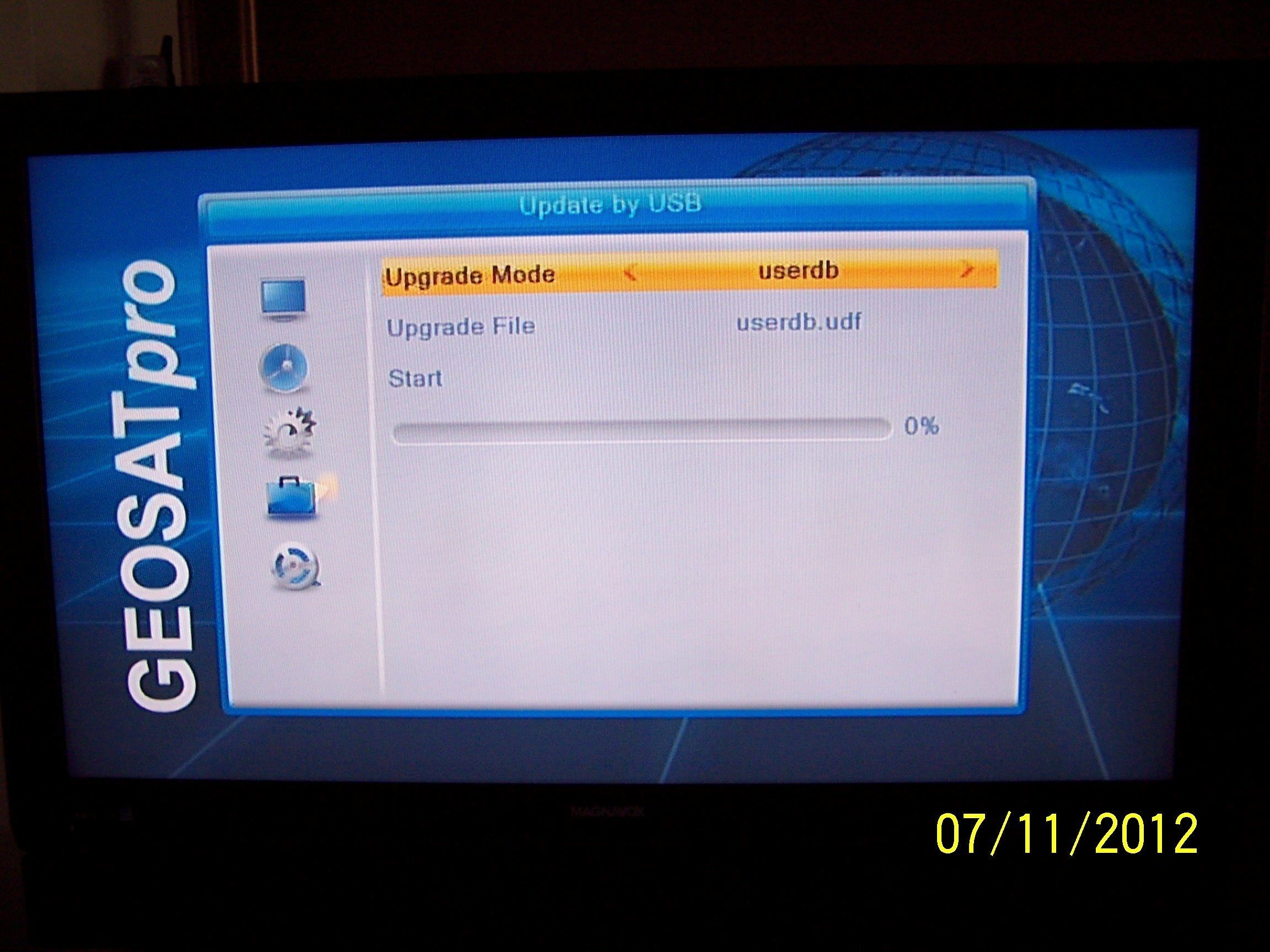

I'm good with the loading and editing, but can you expand on the exact steps of save back to flash drive. This maybe where I'm doing something wrong.
When I load back into the receiver it warns this FW update will wipe all my data!? and does indeed. What FW? I thought I was doing a udb update.
thanks
If you do a channel update (.udf) it loads the channels over the existing ones. After it completes you need to power off the receiver and power back on for the update to take effect

Jim.
Make sure the screen looks like this when updating this file to STB.
AL

Ok, I edited in a small channel change, saved the file using the "floppy disk" icon, and this loaded into the Micro!
