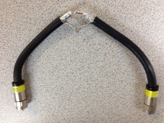

Strange, just a photo upload via the SatelliteGuys Apple iPhone app. I'll try again.

I would temporarily bypass the switch to test it, run coax direct from the receiver to the motor, and see if the motor moves in both directions then. The quality of the coax may be a issue too, H is 18V and V is 13, if the coax has a lot of resistance to it, it could drag the 13V down too low to move the motor on V.
If you measure the resistance of the coax, one ends center pin to the other ends center pin, and shielding from one end to the other end and find a reading higher than 14 ohms or so, coax could be the issue.
Reactions: Titanium
Made a cable like yours, Titanium, and although ohmmeter test is good, no signal registers on the Micro HD from any LNB when it's inline. Voltage test, though, is a rock solid 13.33 volts on vertical and 17.76 on horizontal.
And with the Amiko switch bypassed, and running a single motorized dish and lnb setup, the Micro HD moves readily from 87 to 103 whether on horizontal or vertical transponders. This now suggests good coax, good receiver, and bad switch! Right?
