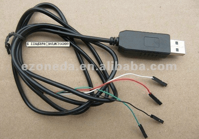

Wire.pngIs this it? Small board PL2303HX USB transfer TTL rs232 module upgrade module USB to serial port

That is a version off a TTL/USB without the connector. You will need to trim back plastic connector covers on the non voltage leads so it will fit the header on the microHD.
Make sure that it is the 5vcc type.
You might want to contact the seller of the recommended convertor. I am sure that it can be USPS mailed into Canada. The seller is a SatelliteGuys member, wallyhts.

Finally, wallyhts sent me the cable and I followed Brian's steps and it worked. Alleluia!
I've just bring it back to life. I hope it will hold on.
