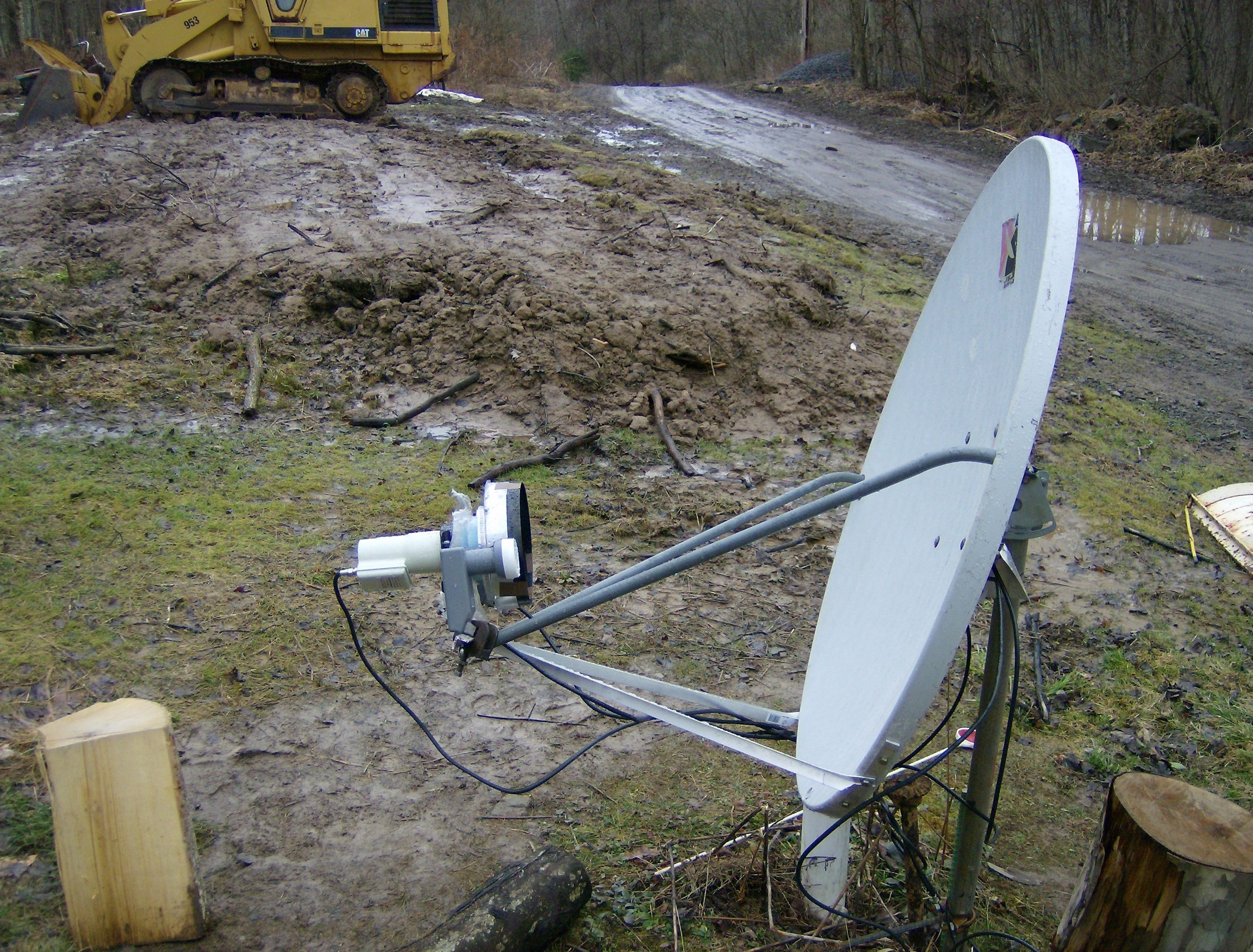

I played around with mini buds for a bit on a 40 x 43" dish. Here is what i learned;
1. needs to go in sweetspot of dish.
2. set conical at edge/end of Lnb , will save argument of fd later on.
3. There are diminishing gains to be had by adding a fourth scalar ring, but the 4th ring helped just enough to allow more viewing on bird 91. Stronger tp's not usually more tp's.
4. U can use all sorts of linear lnb's off to the side of all this, but they never come close to what u get at the sweetspot. I watched 91c, 83ku,,101ku.
All the ku lnb's never had super Q .
5. I can only speak for myself on this next one. for me and my specific dish, i had about 5 more Q (varies and applies only on cband) by NOT skewing the dish.
6. I would reccommend a bud over a mini anyday except where you are 40 stories up and have to hang out your window to mount the dish. u dont want to plummet to the earth and land on a car at 32 ft per second per second. somebody will be mad that u damaged thier car with your body!!
Mini buds make nice toys though.
Here is a pic of my old one before i upgraded to my bud.
Also, walrus has much to say on the subject in some of his input in the forum.
