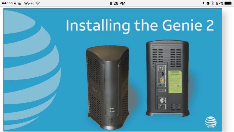

However Directv did not specify which receiver I would be getting.
I don't know what they consider it ... by the time we all see them they will probably give it a fancy name or something .... maybe a Platinum !
Nope, Genie 2 it is
