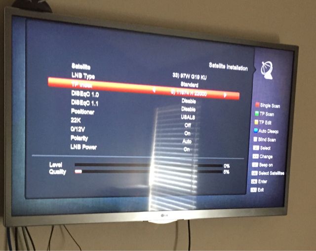

I have a mini HD SE that when I move the dish to a satellite with it all I see is 5 on quality like the lnb is hooked up

Took the picture after using the a3 power cord still the same issue
Maybe reading too much into the photo representing the described problem, but there is no 11874 H 22000 on G19. Are you sure that an active transponder is selected on the mini HD SE for the satellite selected?

What is the LO frequency setting?

There are two diplexers because I need to rune the satellite dish and cable service on the same coax line no switches yet will change that transponder when I get home I think 10750 but will double check that when I get home also don't know how to check lnb voltage
