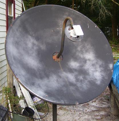

My DSR-410 is on my 5-ft solid and HITS on W5 works real good, signal in the 55-60 range. BabyCG14 009.JPG This dish.
