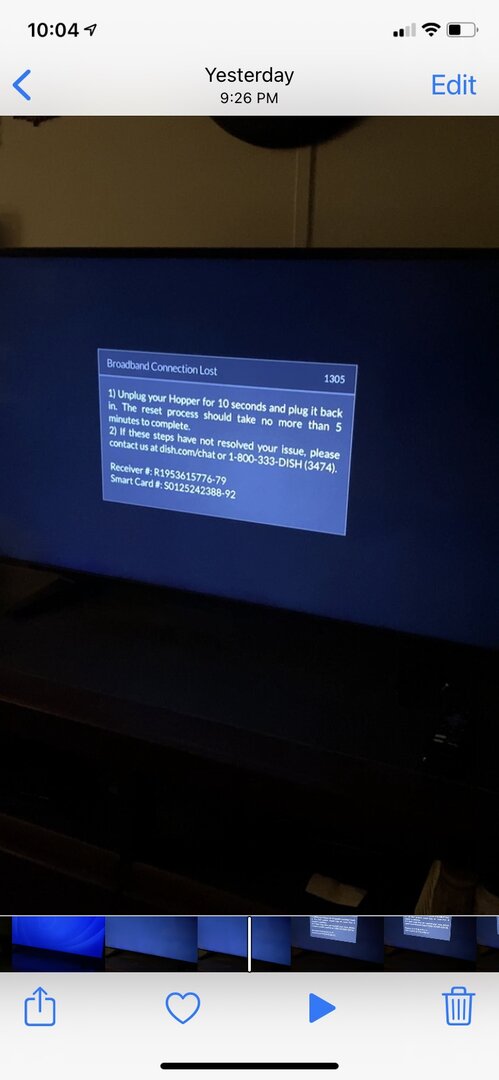

Dish Support ?

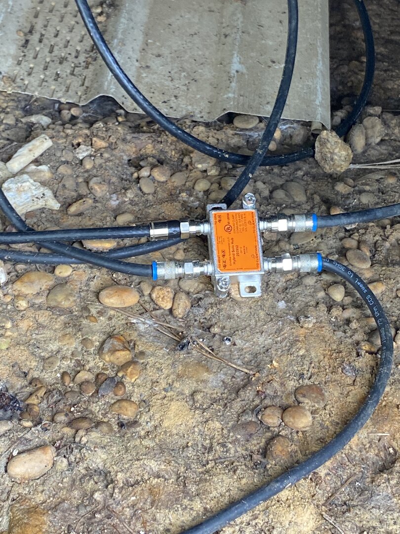

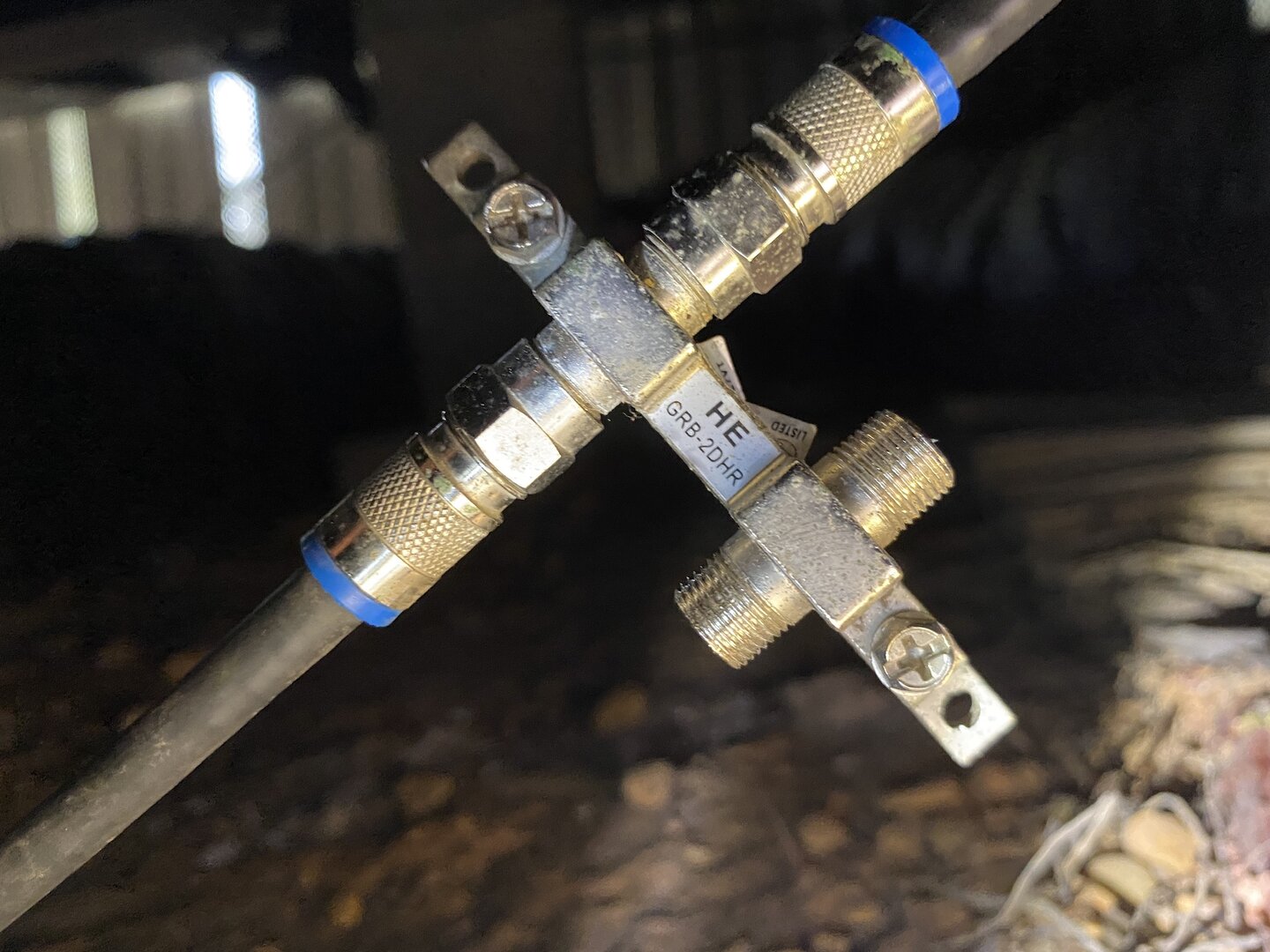

Well, I went under the house and found -see pics- I reattached the hub ground. Should I also do the ground block, it is on host line, which is fairly long. I think it was used as coupler. And several loose connections.

Is that a crawl space or walk under? That equipment is laying on the ground, really! I don't see a ground wire attached to that ground block. You could just as well use a barrel connector in its place.
Under mobile home. when I attached the hub it lifted off ground. I wondered about barrel also, but should I ground that also? My problem usually happens at night so waiting to see tonight(hopefully grounding fixed).
Well darn it! Didn't work had problems again tonight. Guess I have to call tech support.
I see people use Ground Blocks where they should use Barrel connectors often. It mystifies me, what people are thinking.
Grounding is not as important as you think it is and with many homes not having grounds, or other wiring issues, I've seen grounds cause more problems
Any ground blocks need to be bonded to the AC Service entry or there can be ground loops (HUM, you say?) I had a wicked ground loop until I ran a bonding cable from where my Dish and roof antenna cables entered the house back to my service panel. No hum since.
Plan now is I will rerun my host cable and cable to the main Joey(both connect direct to hub). The other 2 Joey's have a run to a 2way splitter. It happens on atleast 2 of them. I'll take that ground block out a make one run. Is there a limit on run length?
