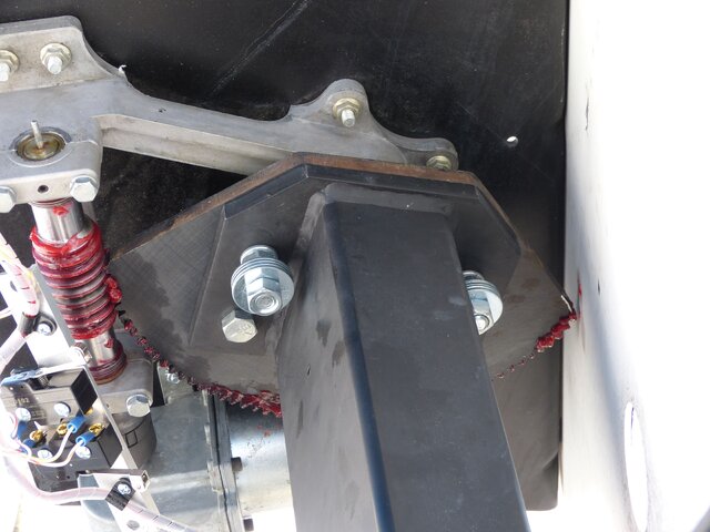

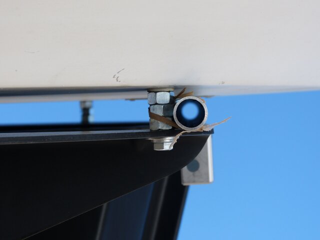

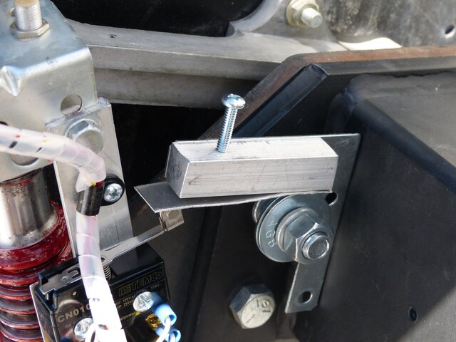

Yep, I get about 142 degrees out of my BirdView. Routinely use it from 36W to 139W and it will go to maybe 178W, but it is pointed into a hill there. I've had it down to 34.5W a few times, but it definitely won't go to 30W.
When I first set it up, the limiting factor on low elevations was the sector gear hitting the back of the dish. I used some oversized nuts as spacers to move the back of the dish away from the mount. Now the limit is either running out of teeth or the mount hitting the pole. I'm not about to find out which, so I added limit switches.

When I first set it up, the limiting factor on low elevations was the sector gear hitting the back of the dish. I used some oversized nuts as spacers to move the back of the dish away from the mount. Now the limit is either running out of teeth or the mount hitting the pole. I'm not about to find out which, so I added limit switches....
From your photos, your motor assembly looks like it's in very nice shape, especially compared to mine. Is it aluminum? I'm definitely jealous. Really fits with the title of this thread - 'More findings to make you jealous' !
