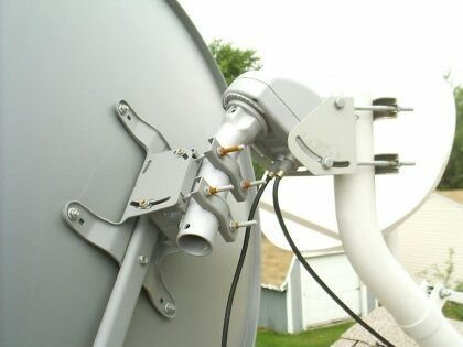

trying to set up with primestar dish
That was exactly I was trying to do with a dish with thicker pipe (primstar)
I have a really old primestar dish (1meter round) and another one with oval. They both have heavy dish holder on the back of the dish.
I'd hate to spend extra money to get a dish and a lnbf if I could somehow use the primstar dish!. thanks for listening.
I have seen a few pictures of it being done, but I don't think you would be doing the motor any good with such a weight, I have three DirecPC dish here and if I thought I could do it I would set each of them up as a motorized system, two of them are Duo's so they have ku and dbs LNB, let us know what way you go!
thinking of modifying the primstar dish
I think I'll try to modify the back of the dish so I can fit the motor with thinner size pipe like dishnetwork.
