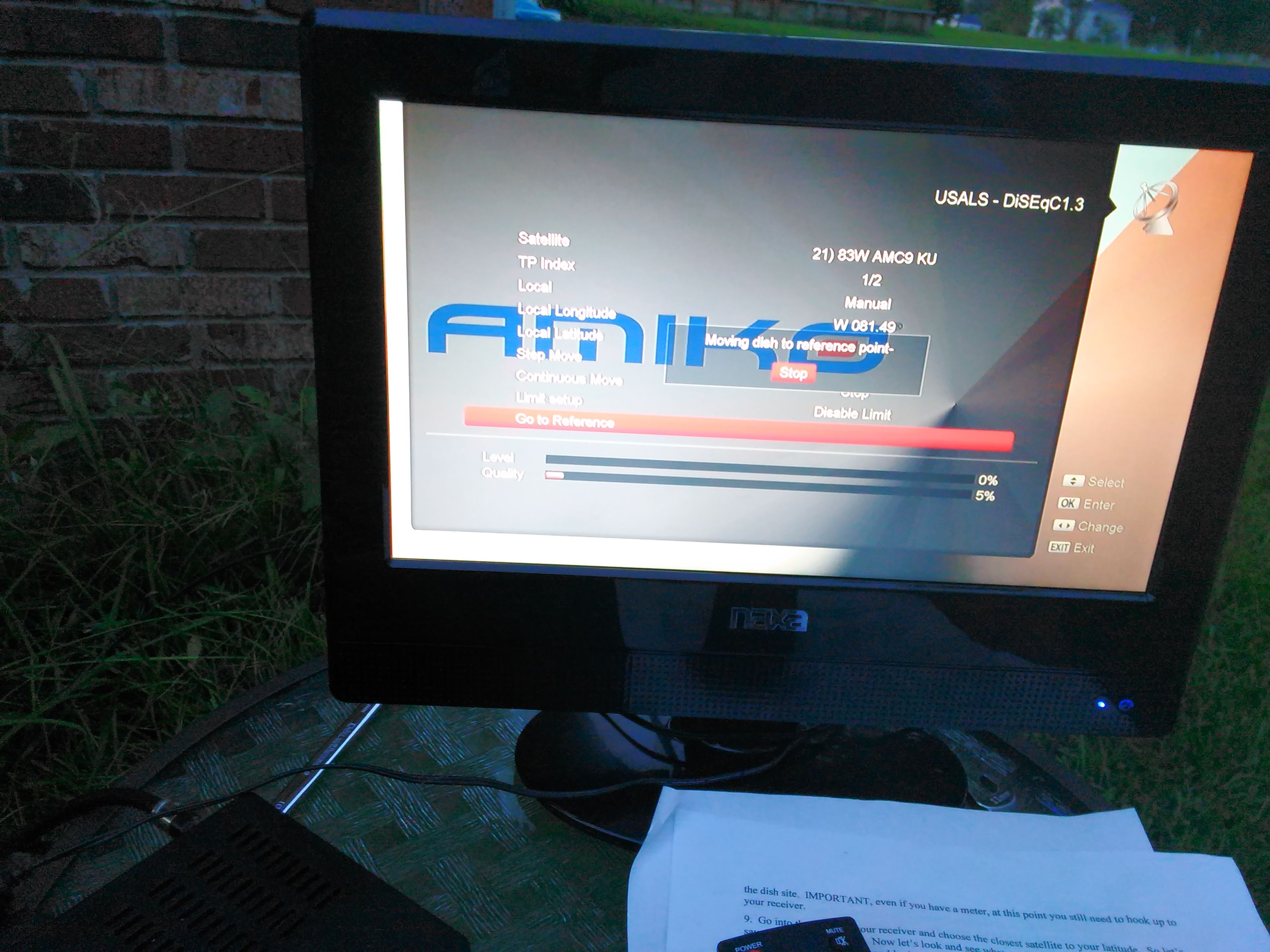

Still no dice , no signal rec'd at all, dish move as it should, lay/long entered at USALS screen. Guessing there is a missing piece somewhere that is causing the issue :(
Not finding the spot with the Mini HD to enter transponder or Horizontal/Vertical or known symbol rate?

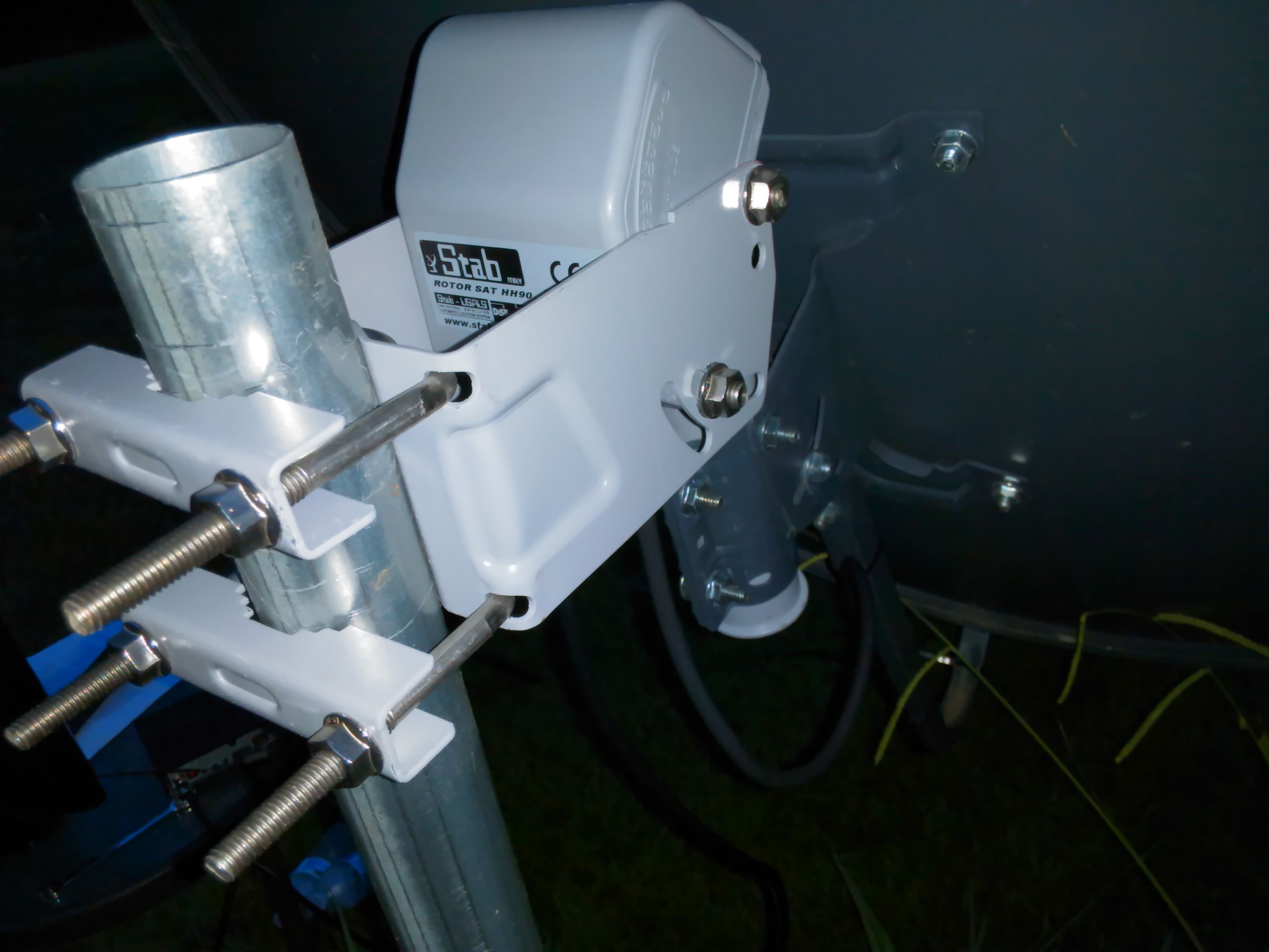

Here are some pictures

Double check that your pole is perfectly plumb, motor is set for correct latitude and lnb is skewed to zero (motor will take care of skew for you). I'm not in front of my Amiko Mini HD SE but I believe the transponder settings are accessed under Satellite Installation. Select the sat you want and USALS should move the dish. The transponders are listed under TP Index. You can select a known good one or press the Yellow button to add or edit them. Once the dish has moved to the sat and you are using a known good transponder you should be able to tweak your dish and get a Q reading then do a scan. :)
