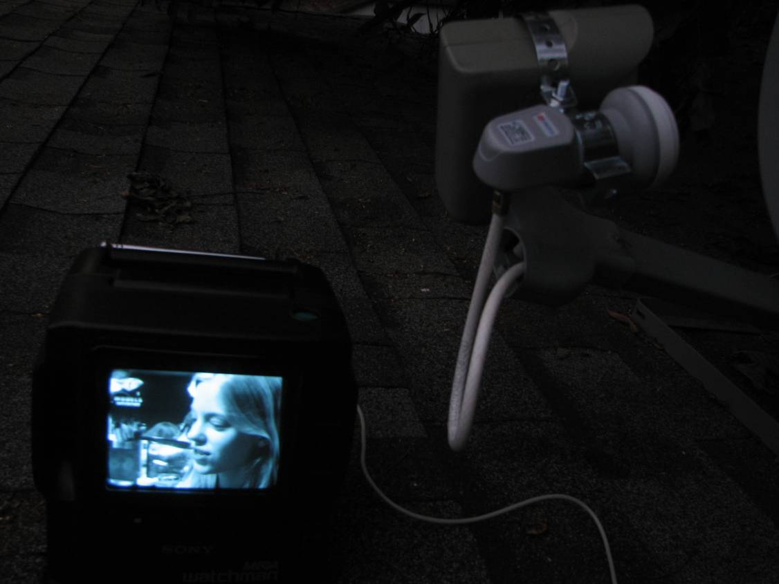

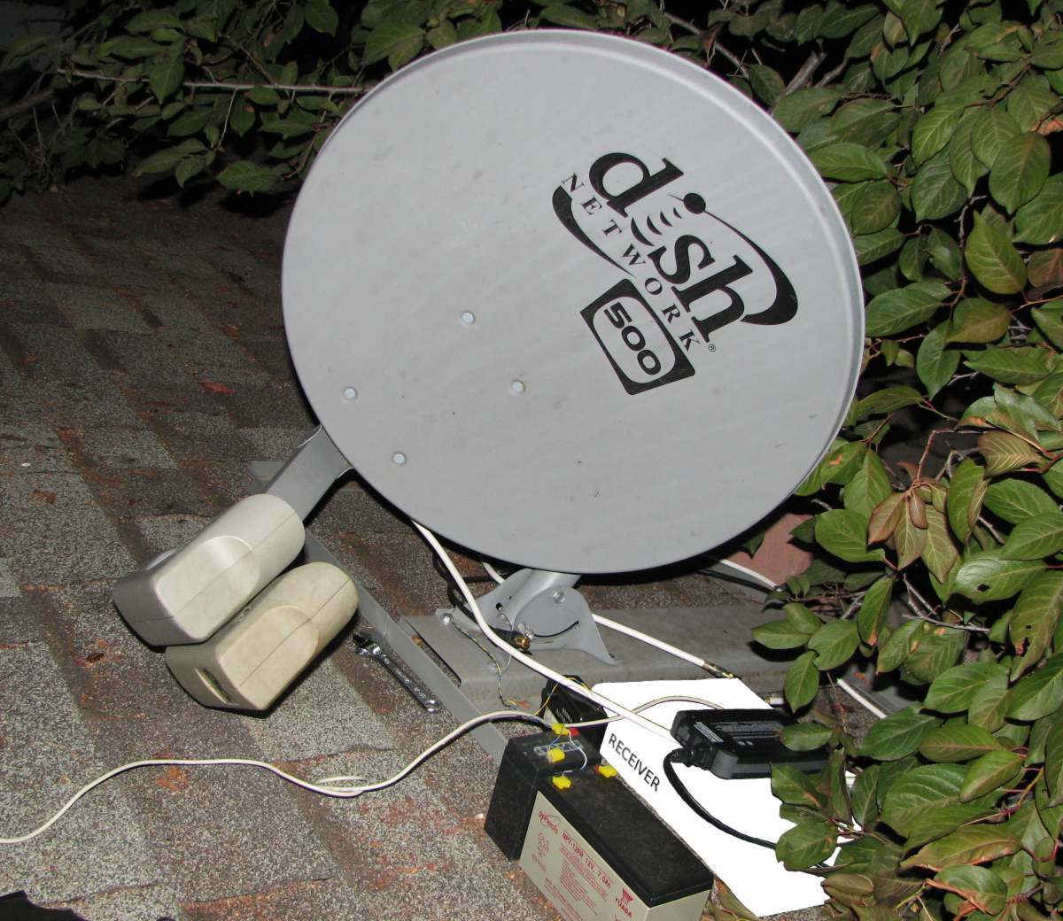

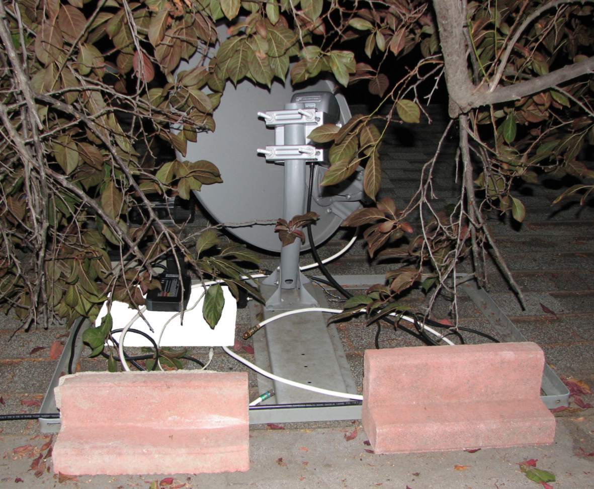

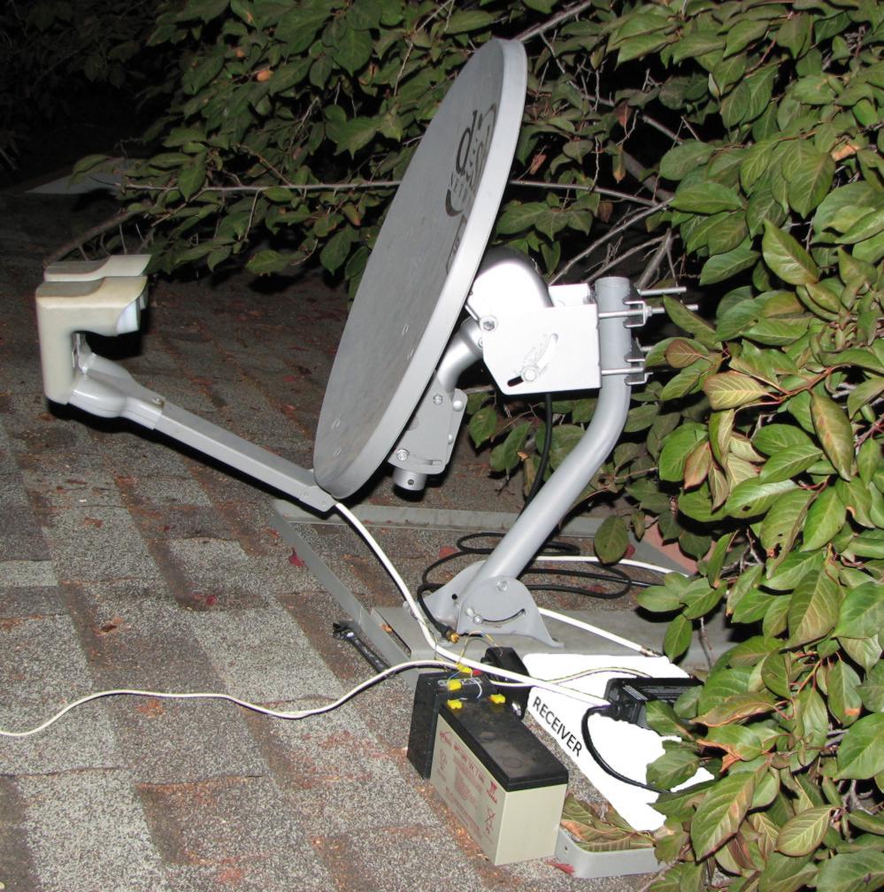

My motorized Primestar is on a tripod, and thus can only be on the flat part of my roof from where I can only see 93W - 129W. The slanted part of my roof has a place that can see as far east as 77W if not more, but there's no easy way to mount another decent-sized dish there and I don't have another good dish anyway. I just happened to have a spare 6-block non-penetrating mount, a Sadoun DG240 motor, and a Dish 500 laying about, so I decided to put them to good use. I'd say more, but I'll just let the pictures do most of the talking. No booze was involved in this project, I swear! :D

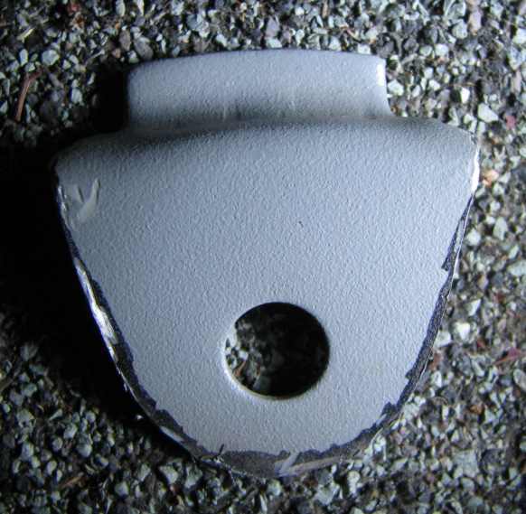

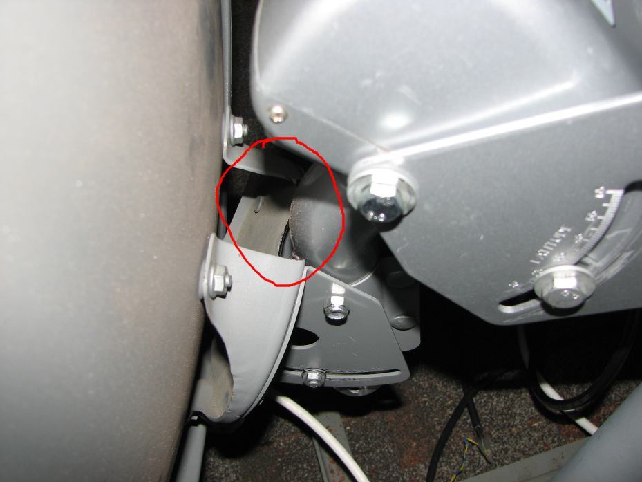

The skew adjustment plate in the back of the dish was running into the motor shaft when I tried to raise the dish to the necessary elevation setting, so I had to cut a notch out of it with a Dremel.

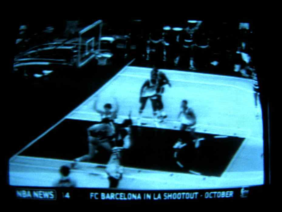

119W is about half a degree off my true south and the LNB isn't at boresight, so I did some calculations and turned the motor shaft a few degrees to compensate. I realigned the motor with the compass, hooked up the 110W LNB, peaked the signal, turned on the receiver, and suddenly found myself watching TV on the roof!
Once I'm sure that this thing is tracking the arc properly, I'm going to put a linear LNB on there and see what I can get. If nothing else, I'm getting one more channel than before, so I'm declaring this project a success :)
Edit: In case anyone is curious, that channel is NBA TV which is currently in the clear at 110W (MPEG-2) and 72.5W (MPEG-4).

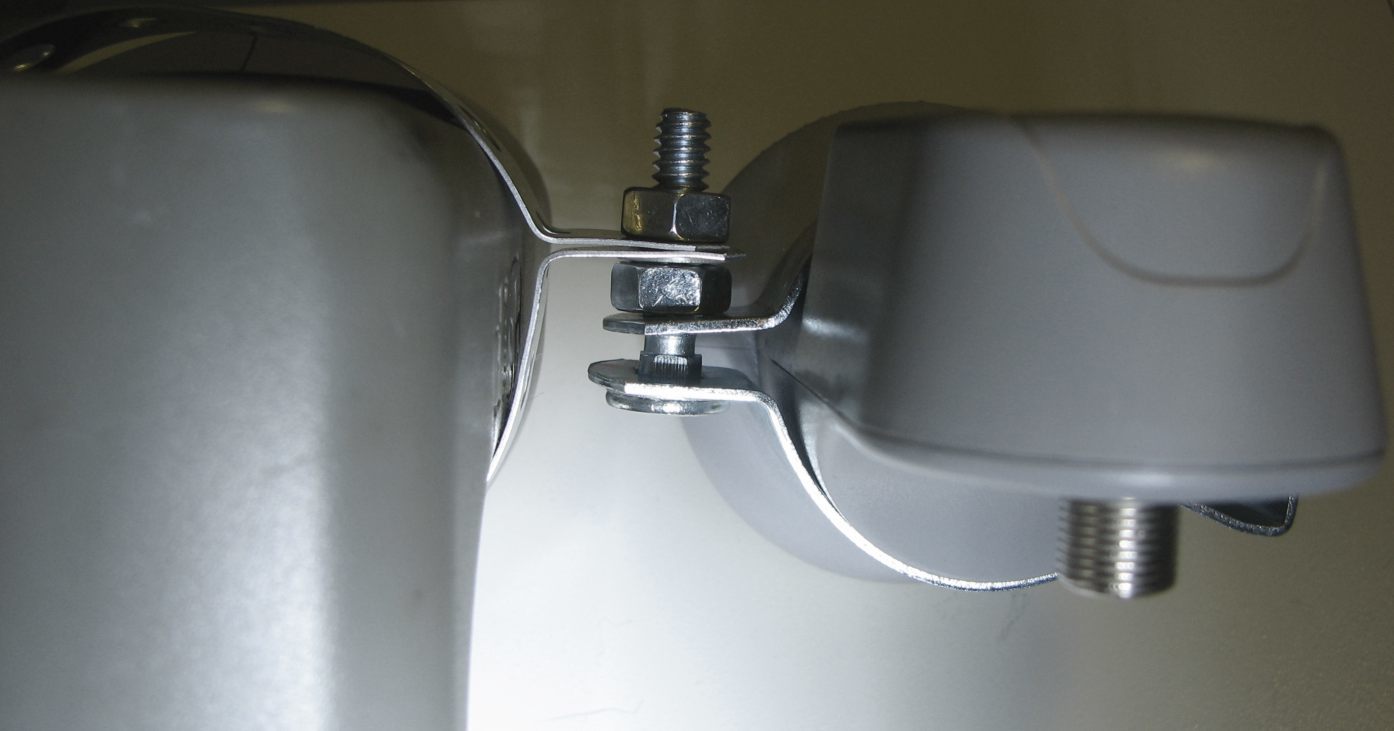

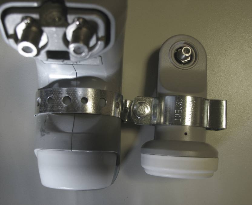

Replacing the circular LNB with a linear ended up being more difficult that I expected. I made a bracket out of two conduit hangers and a strip of steel, and bolted it into the 'D' shaped plastic socket that held the circular LNB. The whole thing wobbled about and was just too flimsy to work reliably.
So, rather than replace the LNB, I decided to make a bracket to attach the linear LNB to the side of it. The parts stack up as follows:
Nut
Steel tape
Lockwasher
Nut
#3 conduit hanger
Lockwasher
Carriage bolt
The end result is very solid. I'm going to hook it up this afternoon and see what I can get.

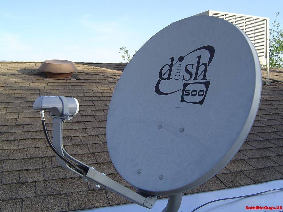

There are some good LNB bracket ideas in this thread, but lots of folks have posted neat pictures with many great ideas in past years.
In the thread above, if you take the links, you'll see where I used a Phase III dish and linear LNB.
That conduit-hanger bracket was secure.
The best one for the Dish 500 that I've ever seen was by McGuyver.
However, I can't find the thread where he posted it.
(see below)
