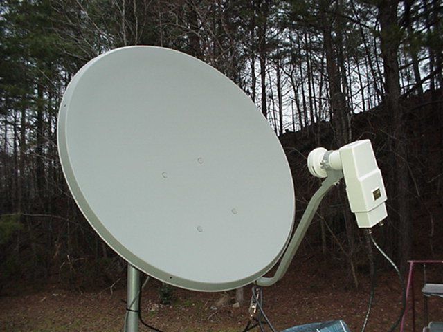

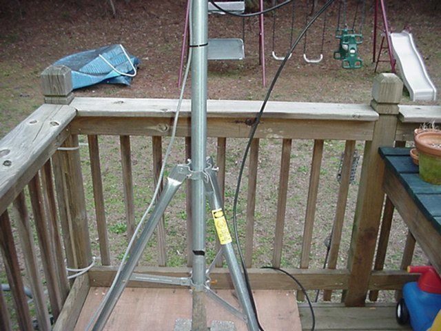

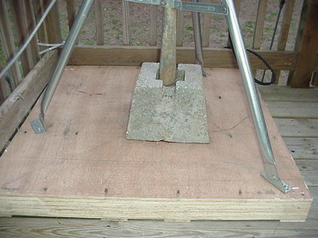

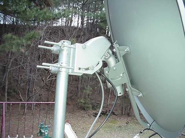

Yes, I'm running a Pansat 90cm offset with a Pm900s motor on a tripod. I used a TV antenna tripod and heavy 1.5" conduit for a mast. All of it lagged down to a pallet.
Here are a few pics of my setup. Mark
Very nice setup Jarhead. I like it how you bolted the mast to the pallet utilizing the bracket that came with the dish. Smart :)

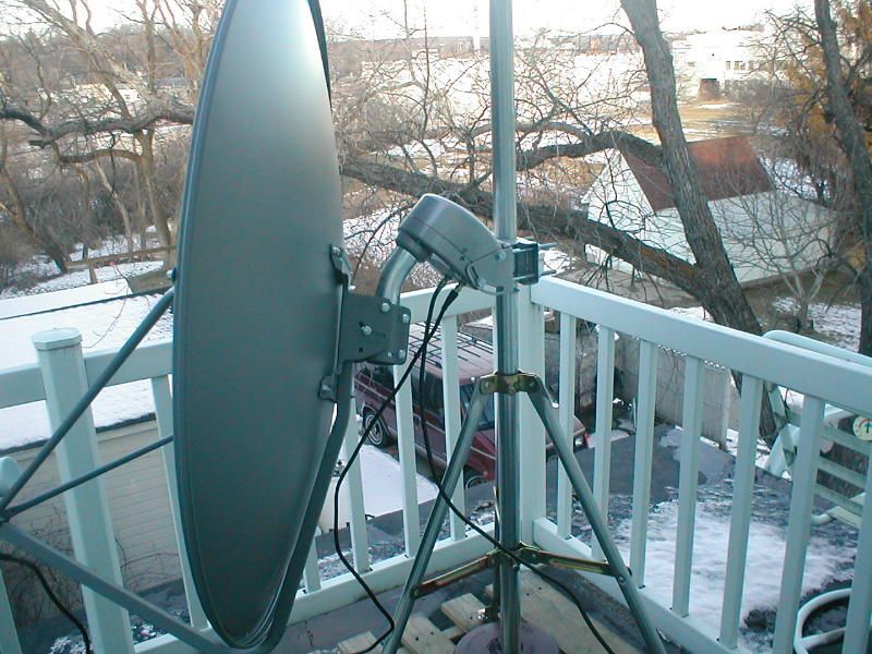

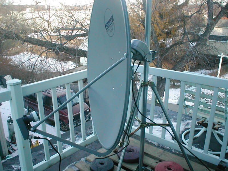

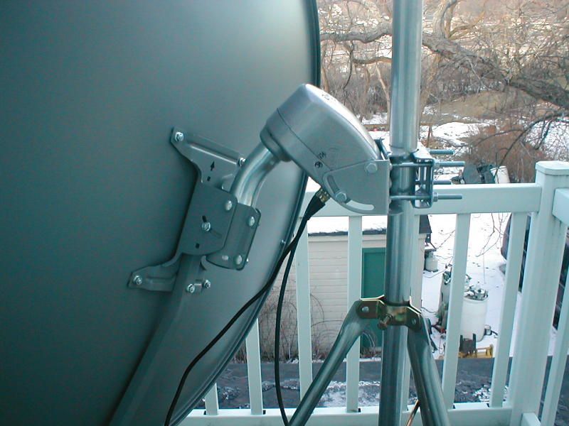

Here is how I did it.
Thanks, I appreciate the compliment, especially coming from one of our Highly Respected Gold Sponsors . The pallet idea actually came from your website, I added the bracket to add stability and keep it plumb. I plan to add another dish to that setup soon.
