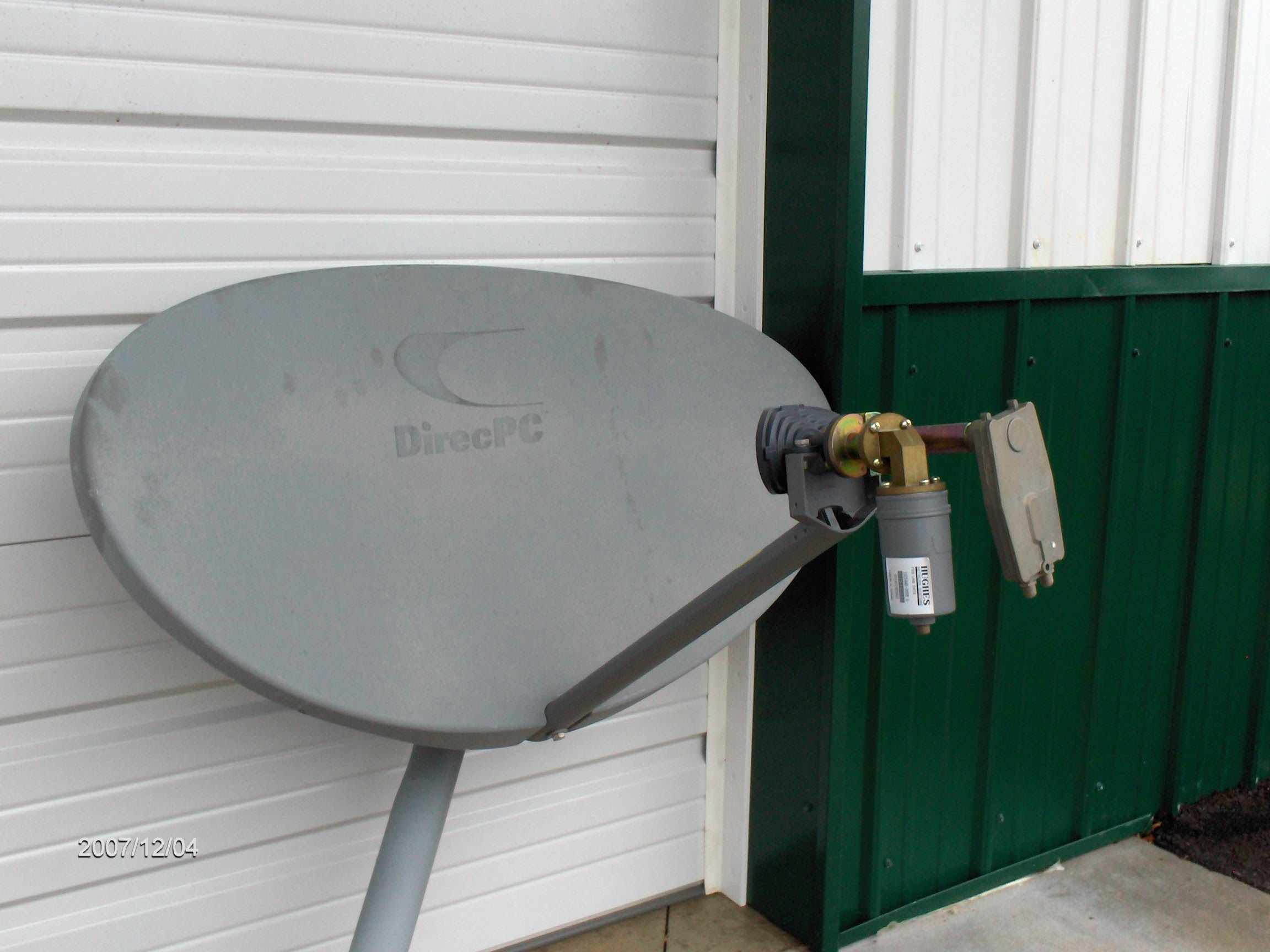

I think I may be suffering from a GCE (gross conceptual error) about motorized dishes. I have recently installed a DirecPC 39 x 24 dish pointed at G18. (see photo) I don't have a motor yet but was looking to get one.
The dealer I purchased the dish from said that since I was only pointing at one sat, I would not need to skew it. (but I did have to)
The way the Motor is mounted, when the Motor rotates the entire Dish is skewed.
Just follow the instructions, set the LNB for Zero skew.
The motor shaft is bent in such a way that as it moves across the arc, it automatically and correctly skews the dish. So, you are correct... If you have the dish mounted on a motor, you'll want to mount it skewed at '0'.
The person who sold you the dish was thinking of circular DBS pay satellites, where skew is not an issue (the only time you have to skew for circular satellites is when you're picking up multiple birds on one dish, such as the Superdish, Dish 500, etc.)...

:)I really appreciate the responses guys! :)Now I've got to decide how to rig a motor to this dish.
I know that I'll have to make some sort of adapter as my mounting bracket diameter is 60 mm. My question is:
Are there any other motors where the antenna arm points up like it does on the stab hh120?
There's a bolt going through the top of the pole mounting bracket on the antenna
The stab seems like a logical choice because it would attach to the antenna from the bottom
Also the stab hh120 seems to be scarce.
Thanks once again!
The bolt is removed and then re-inserted through the bracket and the motor shaft. That keeps the dish locked at the correct angle on the motor shaft.
